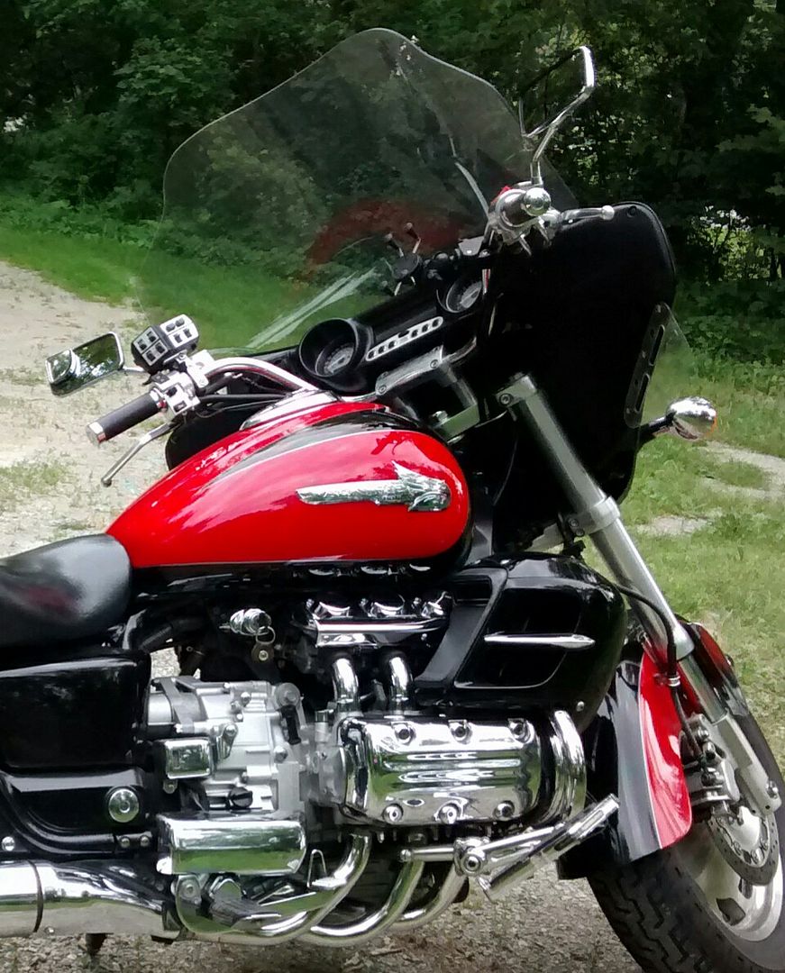

« Reply #15 on: July 31, 2015, 07:08:47 PM »
I'm 6'-2" myself with a 33" inseam.  I have a ShowChrome and was out in the wind today, steady 20  mph with gusts to 30 and it is rock steady with zero buffeting.
In fact, with my previous bike, a 1987Goldwing with a stock windshield, there was a threshold of 15 mph after which riding became unpleasant. Not so on the Valk with the Show Chrome.
One drawback I have noticed is towards the end of the day I don't sit as tall and the top of the screen is in my line of site.  It's been a small price to pay for the comfort.
