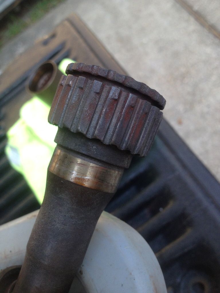

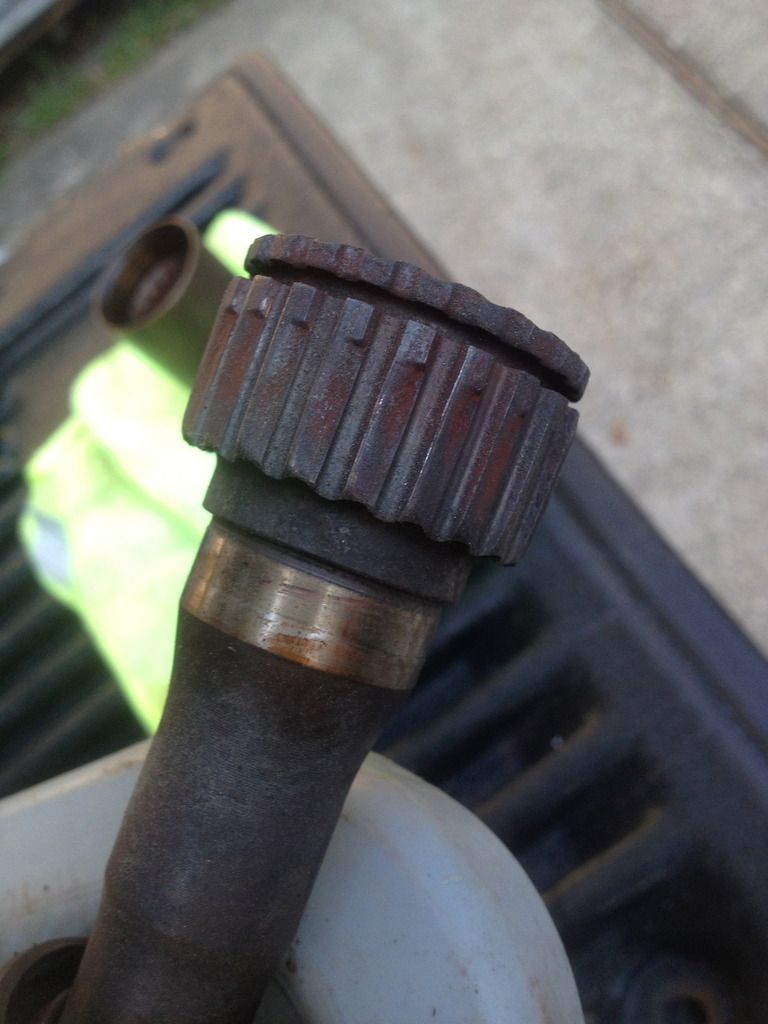

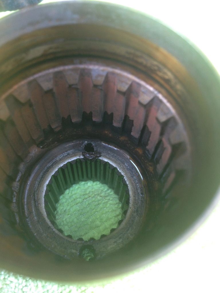

First it was nice to meet trantony (LEON) for the first time at the Waffle House friday morning. After breakfast on to my house where we pulled the old girl apart  and I do mean WE. We found the driveshaft and pinion cup to be shot. here are some pictures
After we got her back together we took a shake down cruise to Morton's Seafood in Madisonville LA. We left there and did some more riding to make sure everything was right and tight. Man the people we meet on this board. Just down right good people. I had a great day (Glad Leon was there to keep me on my toes) and i'm looking forward to a long friendship and to ridding side by side again soon.
