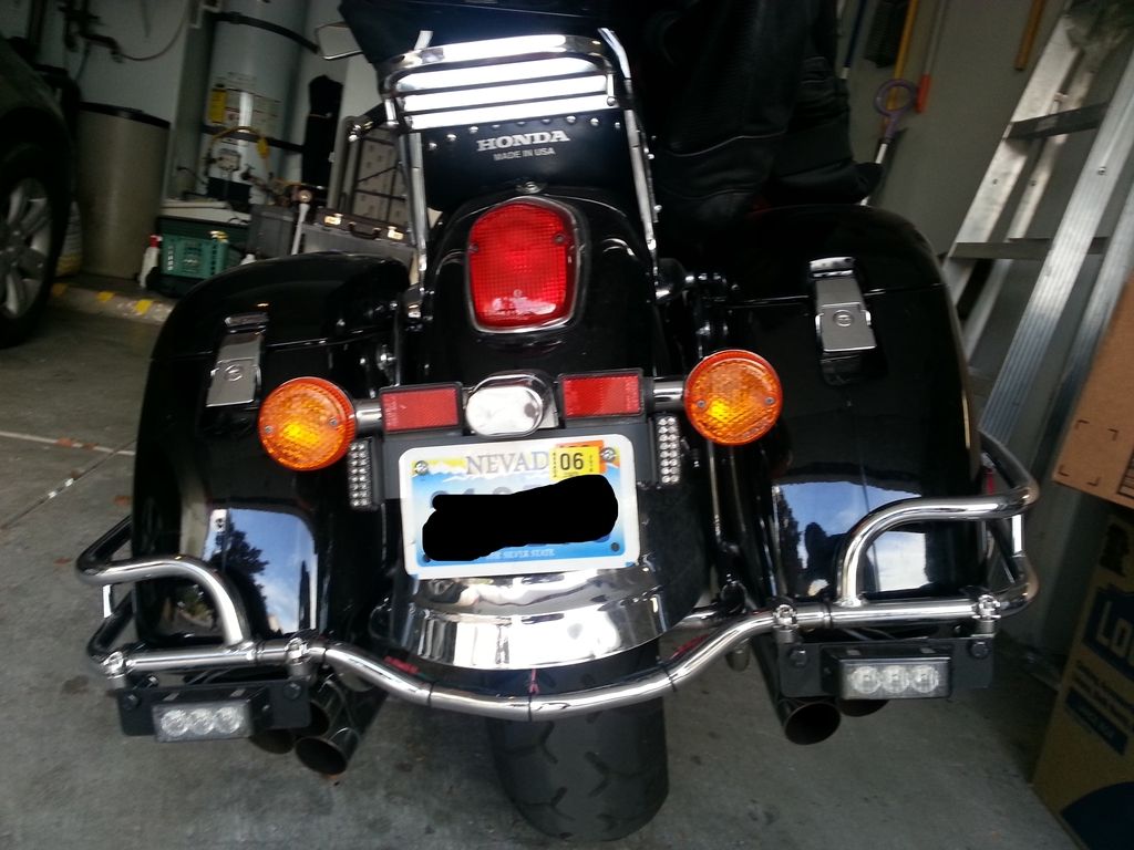

« Reply #5 on: September 01, 2015, 05:21:35 PM »
No but did put this LED bar on along with some small blinks LED's below cooldude
You can see them on either side of the helmet locks coolsmiley

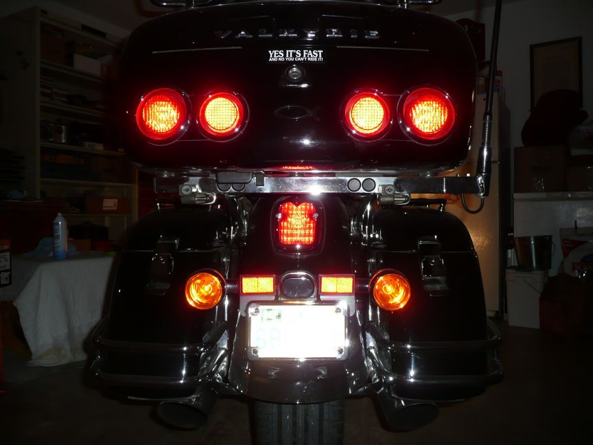

I'm fairly hard to miss.  Replaced the incandescent bulb with a plasma LED, added Hyperlites (you can see them between the turn signals and the license plate) and added red police LED strobes below the bag guards.  The Hyperlites quickly and brightly flash when I hit the brakes and they also serve as running lights.  The police strobes flash in unison with 4 quick flashes and a short period of dark.  I don't think you can miss me unless you aren't paying attention at all.  Hopefully those arent famous last words.

Here's my setup, even brighter with the brakes on. They're LEDs from Radiantz. I've since added smaller LED flashing units that go off like red strobes, just under the fender rail betweent the bags and fender. They alternated and are even brighter.
