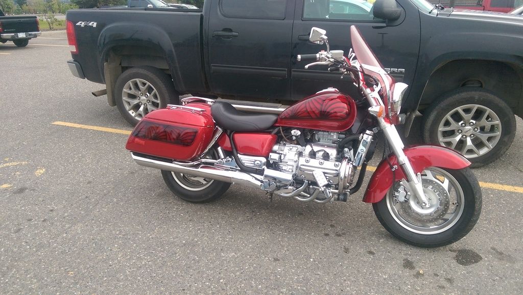

Finally was able to pull the trigger on the supercharged Valkyrie just yesterday.  What a bike, soooo much power!  After spending 7 hours in the saddle the only comfort issue I have with the bike is the handlebars. They have got to go. I hate having my wrists twisted that much to grip the bars.  I've always been a tall bars kind of guy, any body else have that same issue and make the switch to something taller and more punched out?  Would love any tips or suggestions on what's worked for you.

I can't see if you really have Valkyrie bars, or what your risers look like,

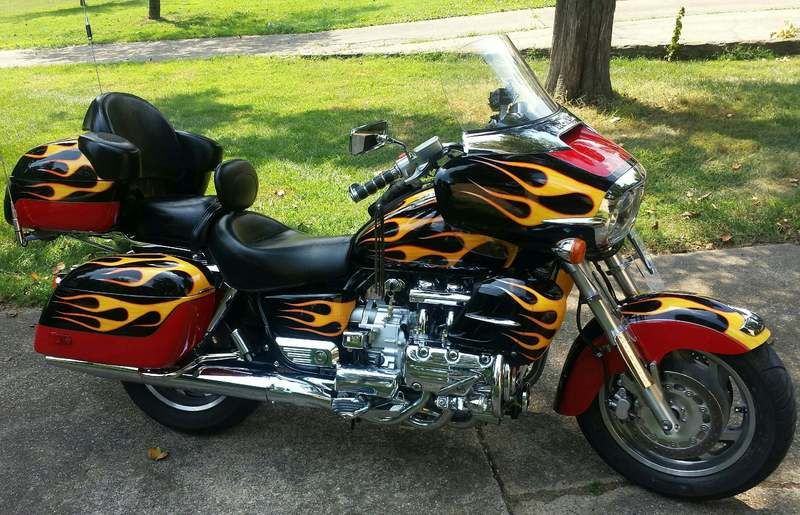

but the whole setup looks swooped up way unnatural... Compare to this:
If you can take some pictures that show the bars and the risers some people might
have some suggestions. I worked hard to get "real Valkyrie bars" on my new
1800 Valkyrie, but of course, one size don't fit all, so you may not like
Valkyrie bars...
If you really have Valkyrie bars, maybe all you need to do is swing them down some.
Don't loosen all the riser bolts without ensuring that your bars don't swing down
and dent your tank... a helper or several thick bath mats on the tank or ...
Oh yeah - nice shiny looking bike  cooldude ... a lot of these blower guys
have great luck with dependable great riding machines that are just
like the rest of ours, except they have a bunch more horsepower...
If you're searching for comfort, a different seat and a backrest (like an Ultimate
or something) will go a long way... I remember riding on that seat you have...
bleghhh...

Looks to me like your bars are rotated up too high. Bring them down till your forearms are level to the ground. That's where you're using chest muscles instead of arms to steer.
I agree.  Just loosen your riser clamps and drop the bars as suggested...

That'sw what I'll do for now. But during winter I'm gonna put on some apes. I had a bike with em on, as well as ridden a number of different bikes with tall bars and they all just feel right.  I'll do a mock up before pulling the trigger on a swap like that. But I can't see me not liking it.

I replaced the puny risers and tiny bars on my 1800 Valkyrie with
giant risers and 1500 Valkyrie bars...
