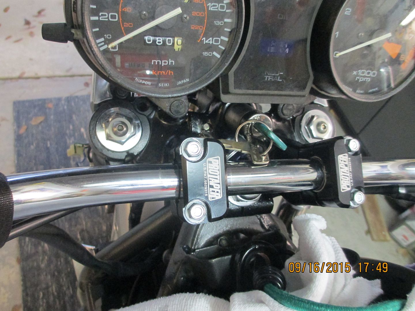

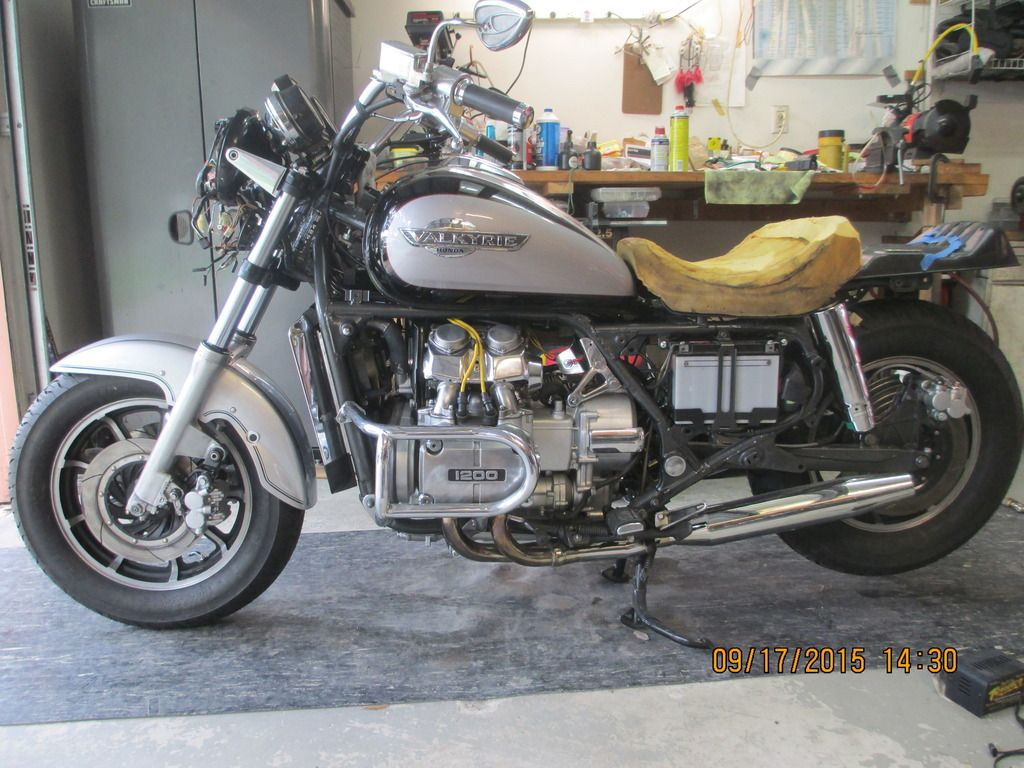

Thought I'd take a couple pics after getting it all back together. Rebuilt the forks, calipers, new front wheel bearings, brake pads, new bearing and races in the steering neck. Got the "new" front fender off Ebay, close match so will probably leave it alone. The back fender off the same bike was really messed up so didn't buy it. The bike is running when I took the profile shots, really rough....especially the left side. Runs much hotter than the right side. I'll get some more hitest duck butter and run it through then let it sit. Don't really want to pull the carbs again but will if needed, it has been sitting for a while. I'll be measuring for the brake lines and the clutch line next, then off to J&P Cycles.

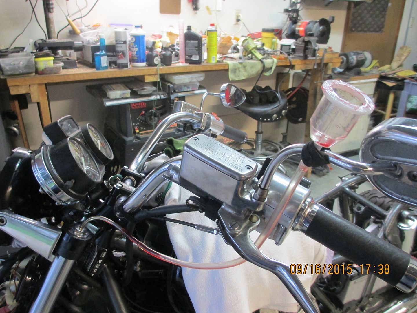

My funnel for filling the forks. Cut the top off an old fuel filter and slipped a small hose over the end. Velcroed it in place while filling, works great.
Drilled and tapped fork caps, 5/16" with a teflon washer under the SS button heads.
Coming together.....slowly.

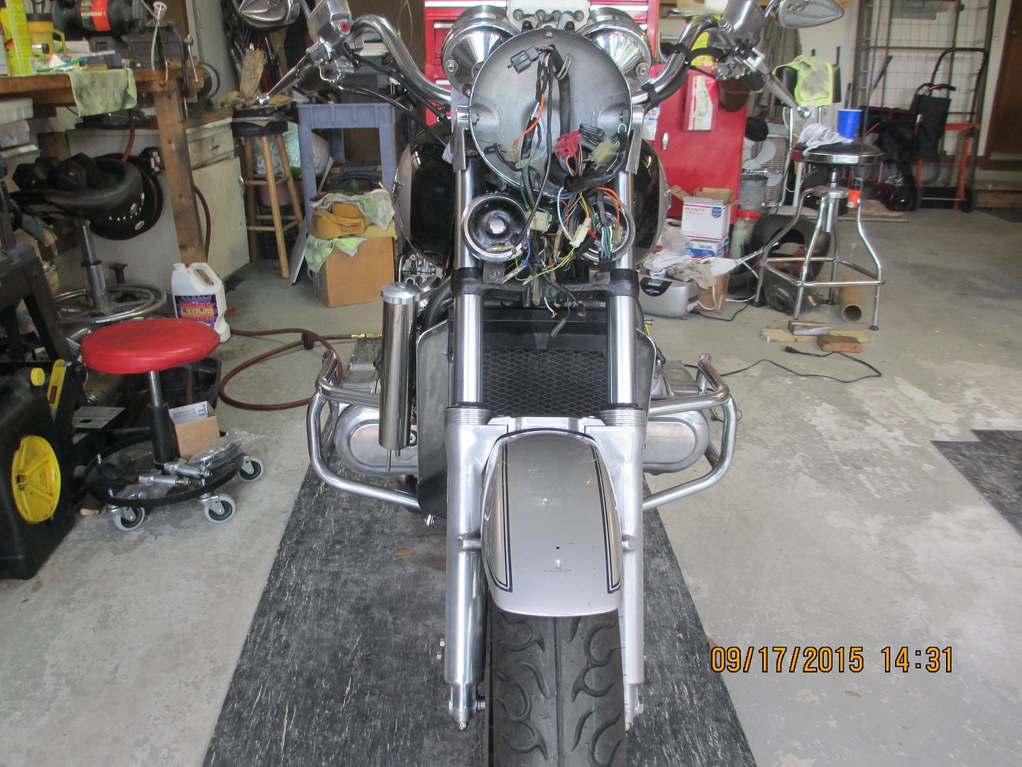

Lots of work left for the wiring, quite a mess.

What are you going to use for headlamp & turn signals? Are you going to keep the stock mufflers?

I was planning on using the stock headlight setup except with an Adjure lamp. Already made the switch just not mounted since the wires are still a mess. Turn signals....school is still out on that, front and rear. The stock mufflers are long gone, a rusted mess. The headers are aftermarket and the mufflers are new take-offs from a Harley($50). I need to have an extension made up with a couple bends in it to move them out and back a little, about 7" long. They hit the frame the way they're mounted now. Eddie, I still have your old tank, what do you want me to do with it? I can't use it and it cost less for the current one off Ebay than to have the old beat up one fixed and painted. If you want, I can put it on Ebay and see if someone wants to mess with it. Just set it up for a $60-70 Buy Now plus shipping just to get rid of it. I have it all packed at the moment, but if it sold I'd just send you the cash.
