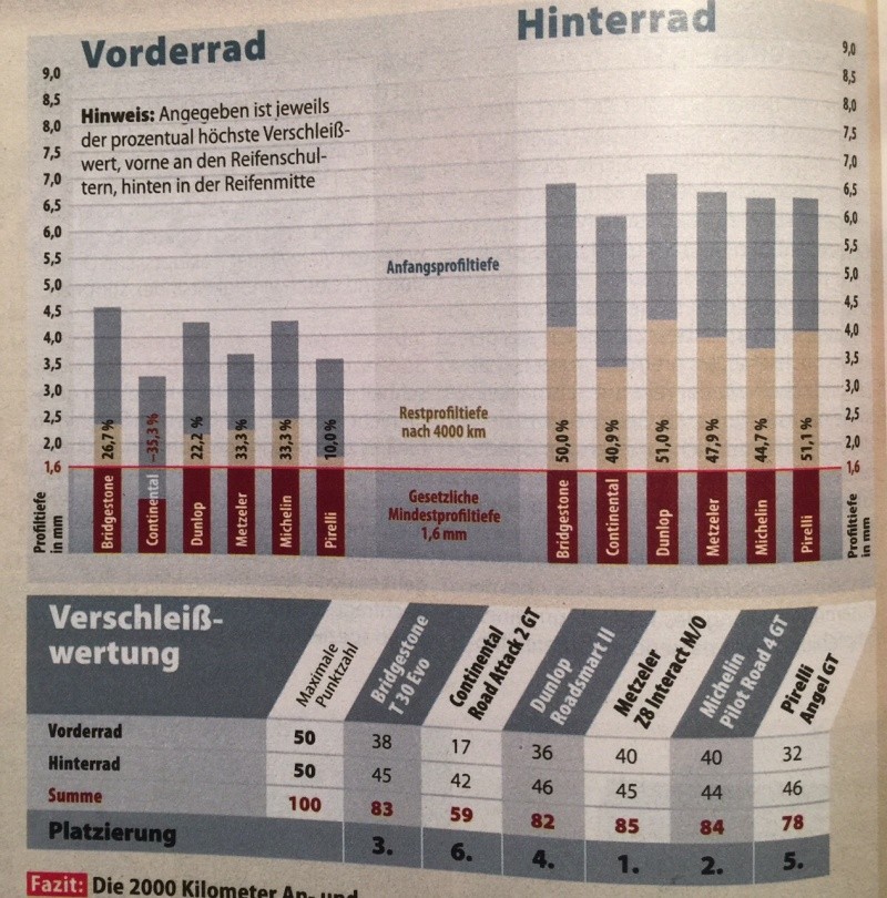

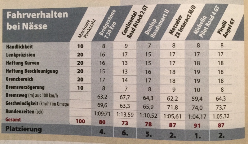

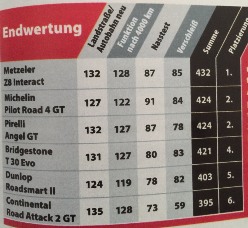

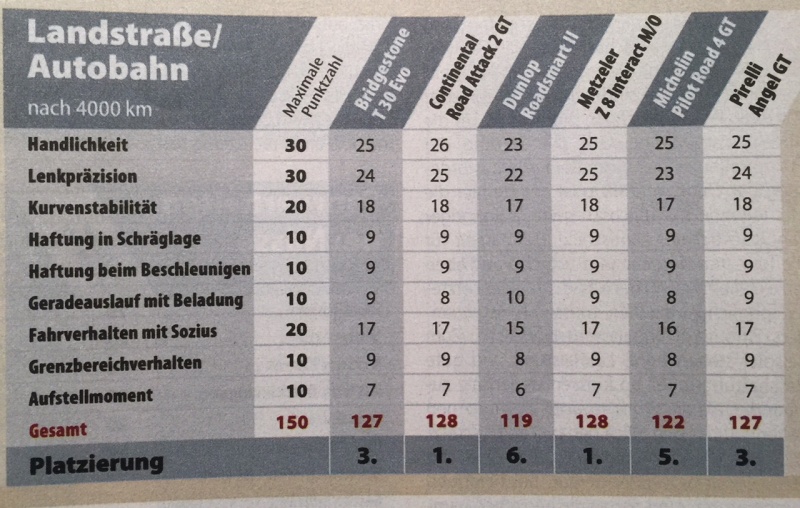

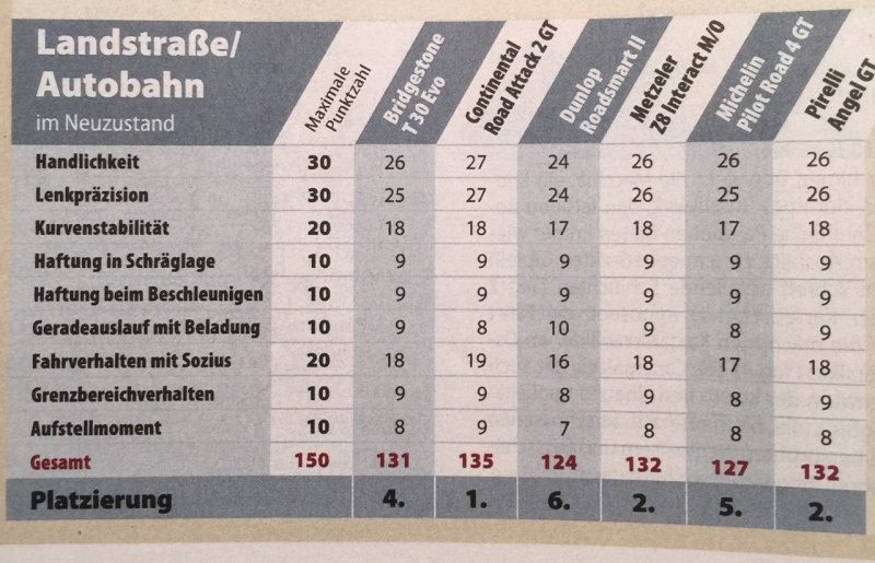

I've had a CTX 1300 brand new and the 1832 Valk : both were slippery on wet roads with their new tire of course. In the ancient world, we have magazines to test comparatively the brands (Motorrad in Germany in fact) and it goes like this :
I'm sorry I don't have time tonight to translate but you can guess what it's all about :
PR4 GT and Z8  are the overall best rated tires. "Bremsweg" means the distance it takes to stop the bike from 100 km/h to 0 km/h and you can see the difference between the PR4 and the Continental : 8 meters !  I guess it would so much worse on wet roads  Embarrassed
I prefer the PR4 GT because it's the most reliable one on wet roads and that's the most important for me  Smiley
