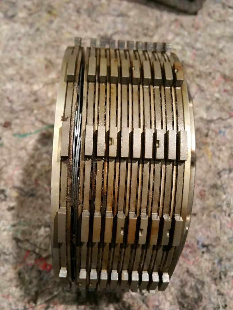

Here are some pics that might help you visualize what can go wrong.
This is what a bad clutch pack looks like removed from the basket. Btw, there is no reason to remove your basket unless it's all scored up from rivets/spacers being thrown around in there. When the rivets of the damper plate let go, all the spacers bunch up on one side. Not only will this make your clutch slip, but your clutch pack will become thicker and becomes the reason why your clutch lever will eventually not pull back fully to the handlebar.

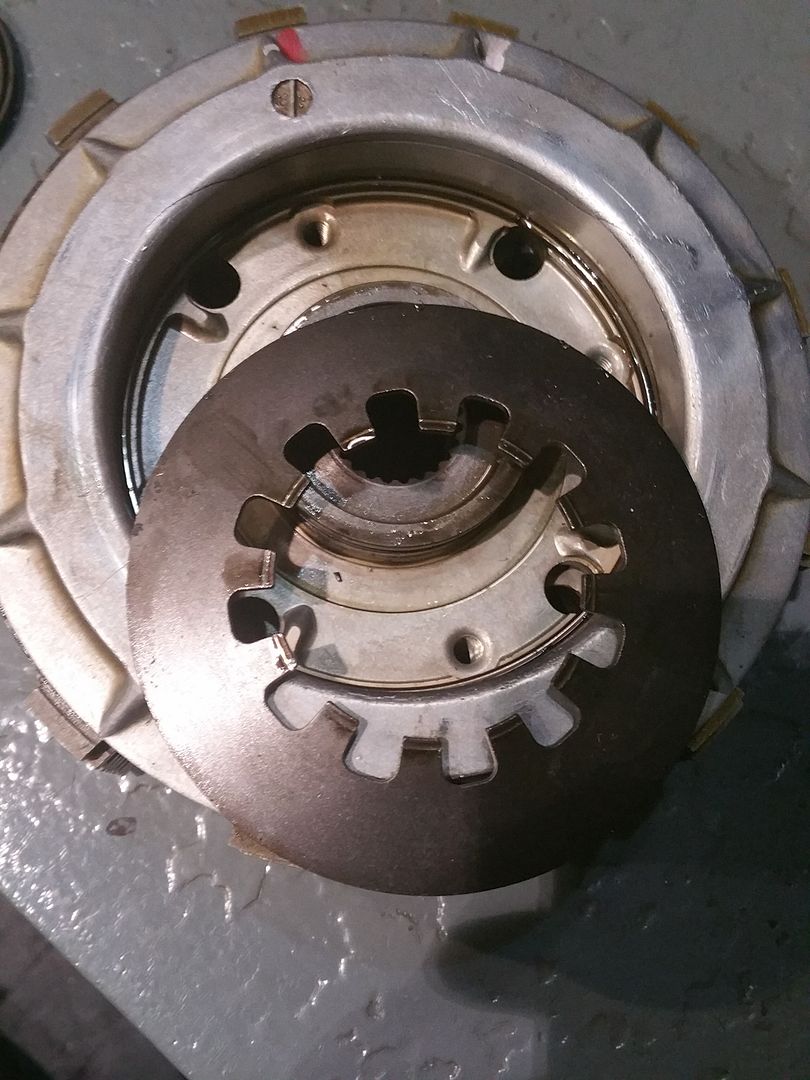

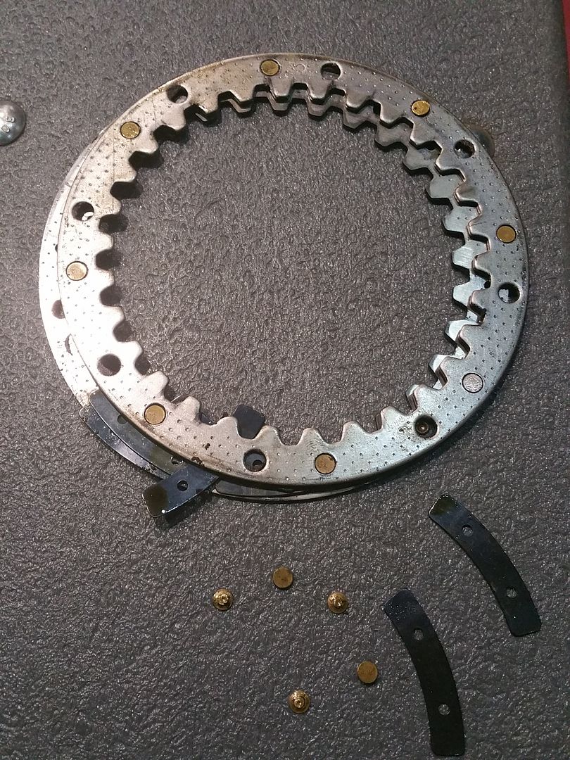

Here is a pic of the damper plate, spacers, and broken rivets out of the pack. If you pull your clutch, make sure you find all the broken rivet parts and don't leave any in your basket.
I was able to buy an entire clutch for 85 bucks off of Ebay. So all I had to do was change out my pack and I was good to go.
I then decided to take my bad clutch to work(where we have a press) and I screwed up. I was pressing on the clutch spring with a socket in order to relieve pressure on the snap ring that holds the pack together. I made the mistake of selecting too large of a socket and instead of just compressing the inner part of the spring, I also cracked my clutch pressure plate by pushing on the outer part of the spring also and rendered it junk. I might still buy a new pressure plate at some point but totaled the bike 2 weeks after swapping the clutch out so I don't really "need" the bad pack anymore.
Here's a pic of the clutch spring removed===and the cracked pressure plate. You can see the hairline crack starting at the 10:00 position and going all the way around to the 2:00 position.
If it is just your damper plate as the main culprit, I believe it's called plate B in the fiche.

The clutch on my '99 went out a few months ago.  When they pulled it apart, some of the brass rivets were not there.  So hoping they were in the oil filter.  Flushed it, put new oil and filter and haven't had any issues.  If you think it's the clutch I would not run it if those brads have come out and have not been picked up by the oil filter.  Could be really costly with that brad floating around in there.

Yeah, loose rivets floating around in your oil is a formula for catastrophic disaster.  Don't be that guy.
-Tom

Hasn't it been true that in all cases when the rivets come loose that it changes the operation of the clutch lever.  It is no longer smooth nor can the lever be pulled in full travel  as when operating correctly.
wiggydotcom
Posts: 3387
Yorkville, Illinois
« Reply #30 on: October 04, 2015, 04:21:50 PM »
Yes, in two ways. The damper plate no longer works the way it's suppose to as it no longer sits flat with max surface against the plates on each side of it.
The clutch lever at some point won't pull all the way back anymore because all of the shims are stacked up in one spot. Did you happen to see the pics I posted earlier in this same thread. You'll see what I'm trying to describe.
The clutch lever movement may be intermittent as the rivets give way, get stuck, and work their way loose.  Same for the shims.
Worst case scenario is that enough rivets give way so that one or more of the spring shims are completely loose.
