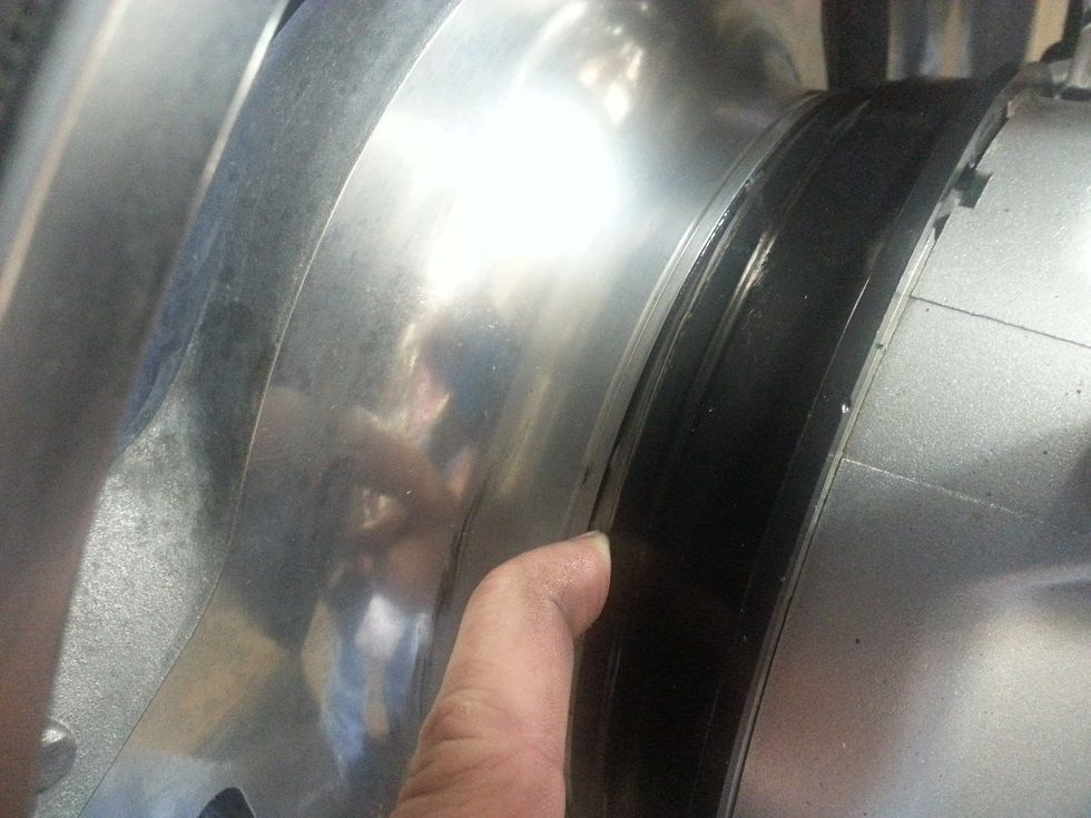

So I just put on the Goodyear Triple Tred in 205/60/16.
I'm just looking to confirm what I think I already know. I don't think I got this tire on correctly, and i'm guessing the Splines aren't lined up. Please look at this picture and confirm my concerns.
EDIT: I would imagine that seam wouldn't show up if correctly installed. Correct?
http://i1052.photobucket.com/albums/s456/sliderjr2/reartire_zpsehjuyedm.jpg

Looks wrong.  I just removed my TT and changed to a N5000.  With the TT (or other tires) my valk did not have that gap.

The Valkyrie most generally will take a 205-65-16 with out modifying anything. Are the O-rings installed correctly? Did you have the plate out that holds the rubber drive bushings in the wheel? Is that plate installed correctly? Is the driven piece all the way in the 5 holes in the plate? Some times-NOT always-ya gotta hold yer jaw just right!  Roll Eyes RIDE SAFE.

USING A CAR TIRE WILL NOT EFFECT THE WHEEL SPACING WITHIN THE SWINGARM.
There is limited space for the wheel within the swing arm. If all your parts were returned to their proper positions during the reassembly and you did not use undue force, I'd say you were OK.
However, removing the wheel and checking your reassembly would be prudent.
Earlier this year I helped a friend with his tire removal and reassembly when he bought a new tire, caused him to panic also. After looking at my own three valks, he was convinced that it was OK.

May have too much grease in the bottom of the ring gear cup.   I've seen that hold the rim out about that far before until you press in hard enough to squeeze the excess grease out.
Also keep in mind that it is good to put the axle through the swingarm/rim before sliding the wheel into the final drive.  This ensures proper alignment so that you don't cut the o-rings, especially the large one on the backside of the flange splines.

That seam will show when correctly installed. Short of it is...if you can get the spacer in the other side (without destructive force!), it's where it belongs.

There is nothing wrong with it. That is a plastic dust guard and needs clearance so the wheel can turn. Mine looks the same.

cooldude Exactly!  For me, the bottom line is what Daniel said about the spacer and the rear brake caliper fitting properly between the wheel and the swing arm. If it all fits, you have it right. You may already know this, but here's a tip when reinstalling the brake caliper. There's an indentation on the inside of the swing arm where the axle comes through. If you rotate the caliper almost 90 degrees clockwise from its normal mounted position and then attempt to slide it over the brake disc and into position between the spacer and the swing arm, it goes in much easier.
