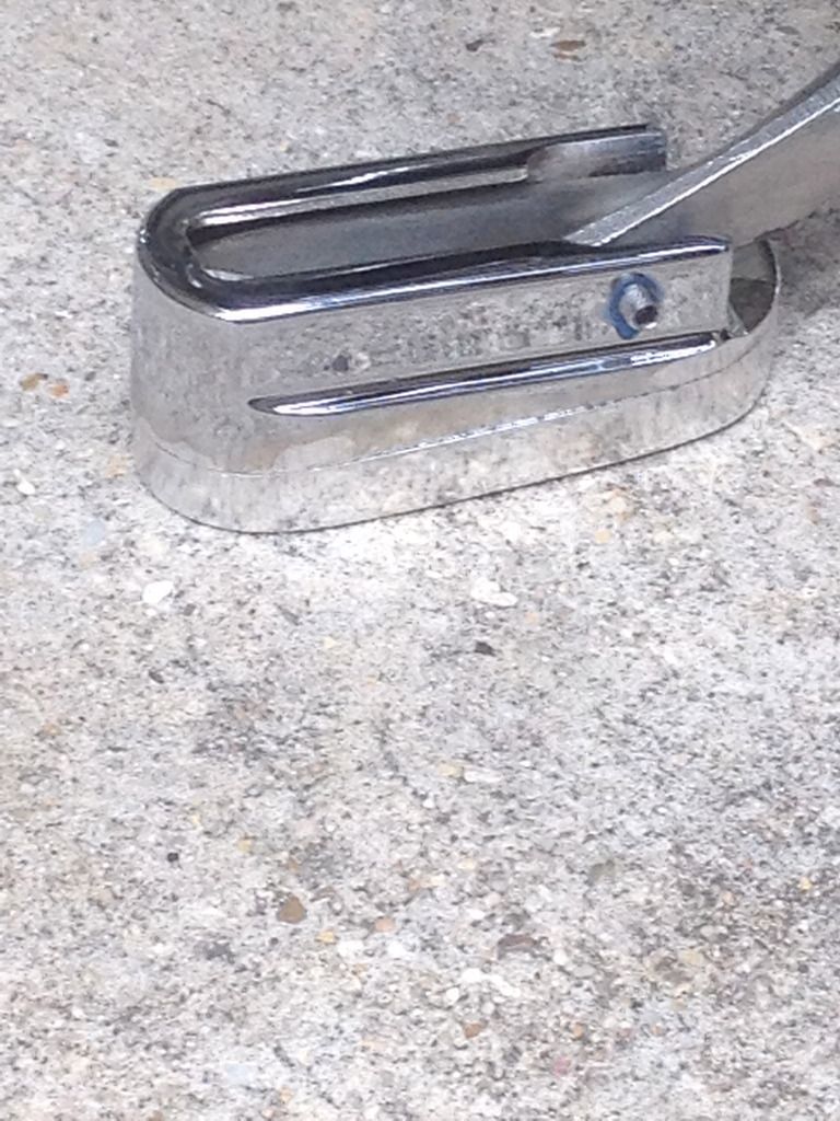

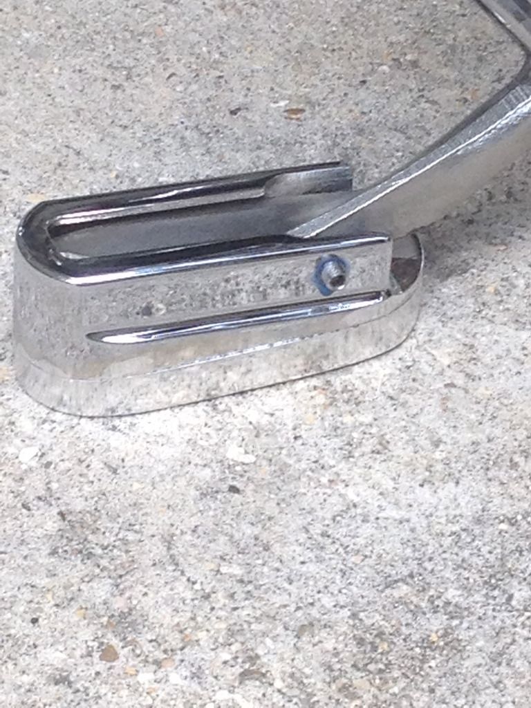

This is what i did to solve the problem I used a kickstand pad for a 1800 VTX and added 1/2 inch aluminum plate cut out to fit. Then drilled and taped and countersink from the top of the pad and polished it this is how it looks.
Hope this helps Dennis

Thanks Dennis: Beautiful job, looks like a good idea and a great solution. Where can I get the VTX pad ?

Eagle 1 the VTX pad came from Cruiser Customizing Its a Rivco part# RIV-VTX013 Hope this helps. It was $39.95
  Dennis
