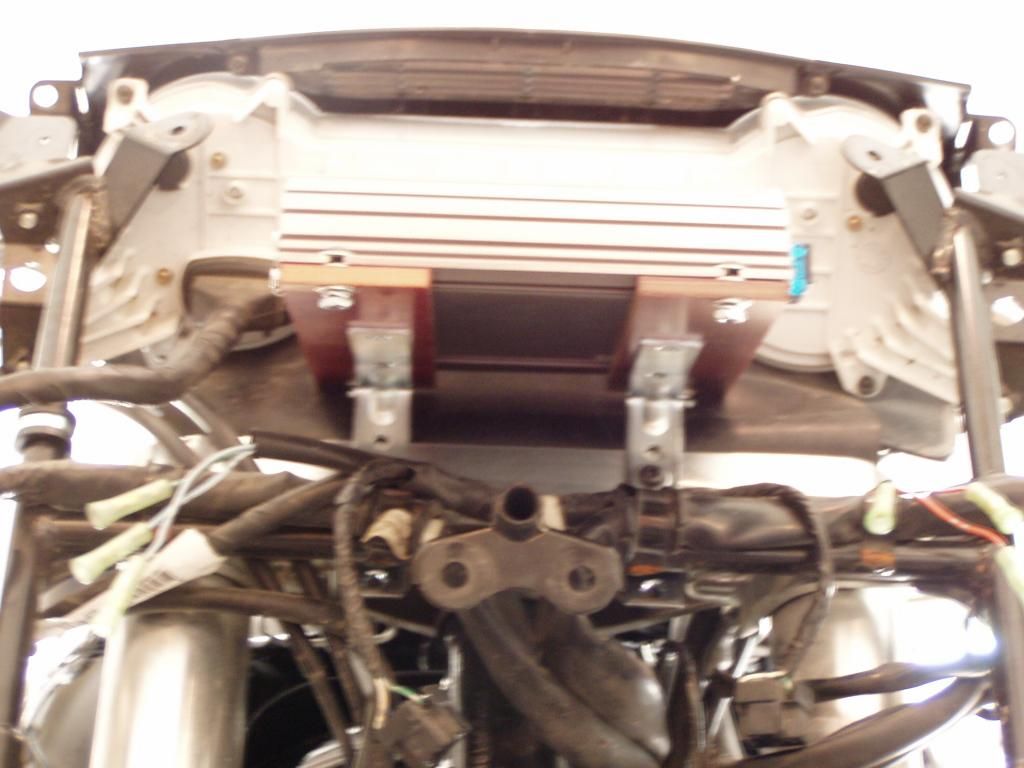

Here is how mine is mounted.  Took two years thinking about how to do it and a lot of measuring.
4" angle brackets mounted to the upper triple tree, threaded the holes, with lock washers and jamb nuts on the back side.  Those 2 perches are bakelite/phenolic.
I never did take pictures after getting it all wired up and cabled.  Maybe the next time the fairing is off.
