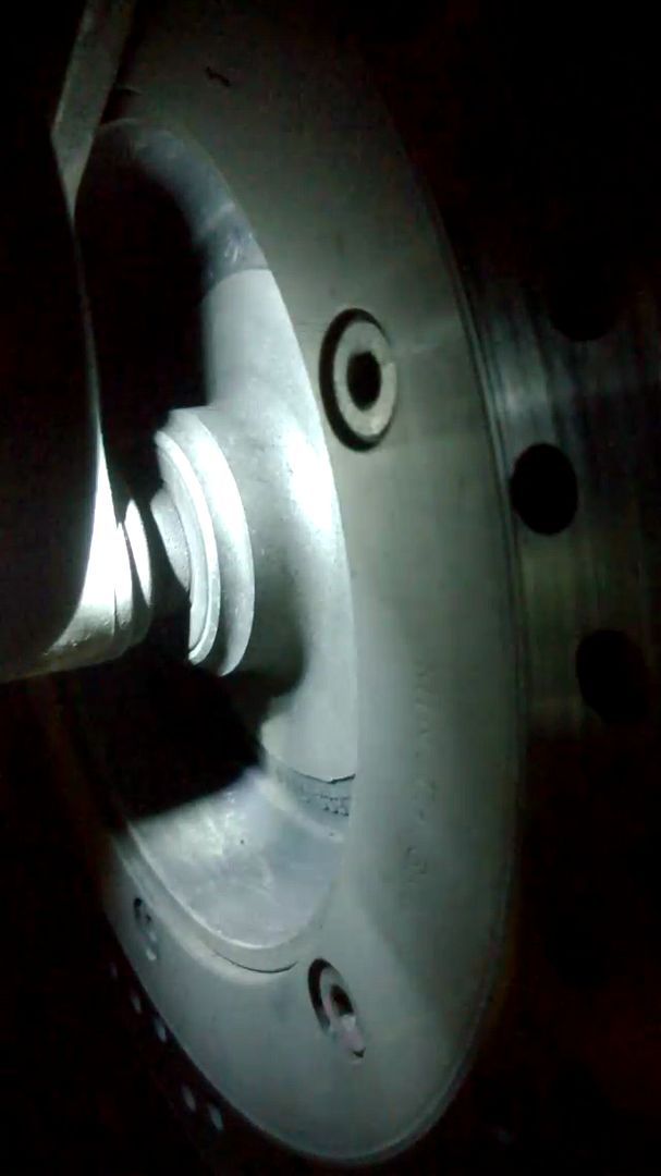

I'm posting this quote from my YEAR OLD thread, view the video to see what a bad left bearing looks like.
I am really anxious to figure this out too, trust me.
I put about 8-10,000 miles on it before replacing the rear tire. Wore out the Cobra.
I found old grease, no visible wear then.
I used the Honda moly paste grease, same as the Oldwing. It goes through a lot of tires, so I am well familiar with what needs done. The splines were good and the driveshaft cup was cleaned up and repacked.
There is probably 10-14,000 miles on the car tire since then. ( bought at 22k, wore out a Cobra, put on a CT, now at 46,000).
Last evening, I got it up on the jack and removed the saddlebags.
Grasping the tire,  I can feel play in the left bearing. Enough to lightly thunk.
You can see a gap open and close. I took video, http://s825.photobucket.com/user/Earl43P/media/WP_20141014_010_zpsrp4fcrfa.mp4.html?o=0
I may get it disassembled tonight.

EEEEK!!!!  That bearing is toast.  Replace both sides as the other side wont be far behind if not buggered already.
