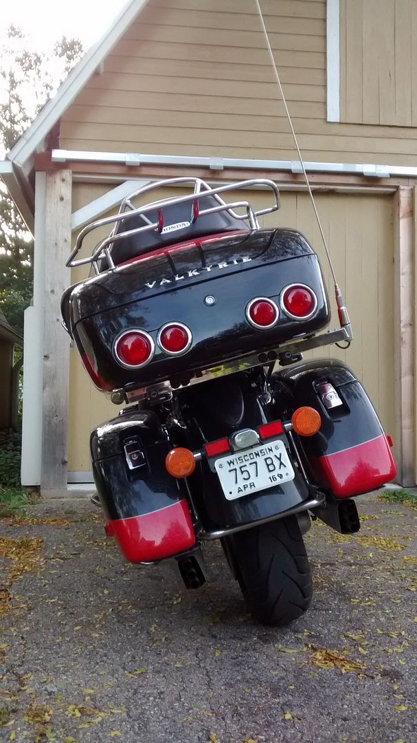

For sometime I have been concerned with the excess lean of my 99 Valk, especially since I dropped it once while parking on a hard gravel road. I have viewed many of the photos on "justpics" and note that they all seem to lean much less than mine and also that their kickstands contact the ground much more than mine. I have checked and found nothing loose, broken, or bent, thus I am at a lose as to just why it seems to lean so far over, and how I might correct it. I did post this information earlier but had no photos of how it leans. I am not concerned about being able to pick the bike up from the stand only that I do not wish to pick this monster off the ground again. After viewing my photos please compare it to yours and give me your assessments.
Thanks
http://vrcc.photostash.com/vrcc_36588/kickstand 2.jpg
http://vrcc.photostash.com/vrcc_36588/kickstand 1.jpg

Some have reported the cross member gets bent.
The view of the back of the bike shows a lean that would spook me too.

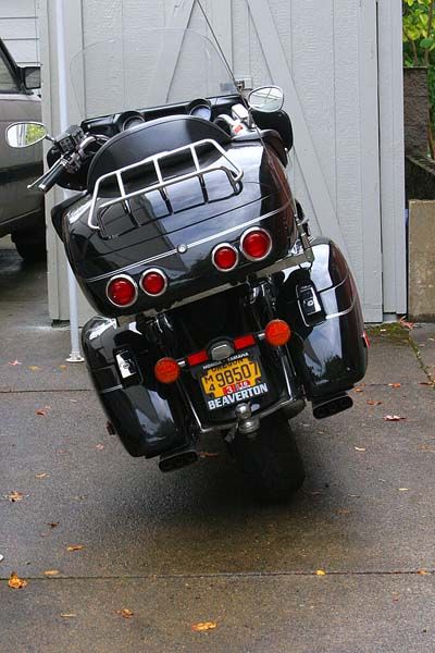

My standard leans almost that much.  I always had the thought that I could put a washer in the mount to take up slack in the kickstand.  As it settles down on the stand there is a substantial movement of the stand that I think could be minimized by a washer.

My 99 IS has always had what I considered to be an excessive lean on the stand as well ...very similar to what your photo shows here. I've had it checked at two separate dealers over the years ... nothing found amiss. I've made a chock for the stand in the garage for when it's parked so ithe bike stands a bit more upright, but have never had any issues when it's parked elsewhere. I have seen a chrome "extender boot" for the Valkyrie side stand at one time ... can't remember if it was on ebay or whatever.

Ther bottom picture looks pretty normal to me. When your bike got dropped, did it get loaded on a flatbed and towed away? Sometimes these gorillas that drive flatbed tow trucks, use a 3 point tie down model, with a chuck in front and leaned over on the side stand and then they use ties downs with big mechanical ratchets and tie down so heavy that they bend the kickstand.
I had that happen on the one of mine that got totaled this past June.
But it's hard to tell, but it looks normal to me.

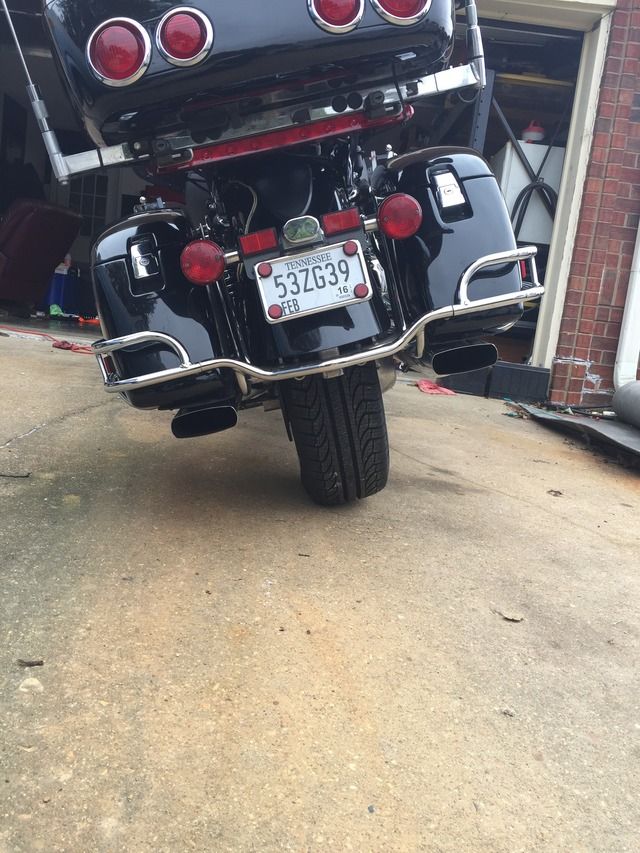

« Reply #10 on: October 07, 2015, 06:53:38 PM »
My I/S is the same way. I park it on a 2 x 6 in the garage. I've bought the adapter for a VTX at cruiser customizing but looks like I will have to heat and bend the bottom of the stand to make it work

my '98 tourer leans that much or maybe a bit more, though my sidestand foot is flat on the deck, so I'm guessing that's how Honda designed it.  I was also concerned about excessive lean (do a search and see others' similar comments), but I've concluded it's more or less supposed to be that much.

« Reply #23 on: October 08, 2015, 08:26:03 PM »
What size is that car tire on the rear?
If your asking about mine it's a 205/60/r16 pirelli P4
