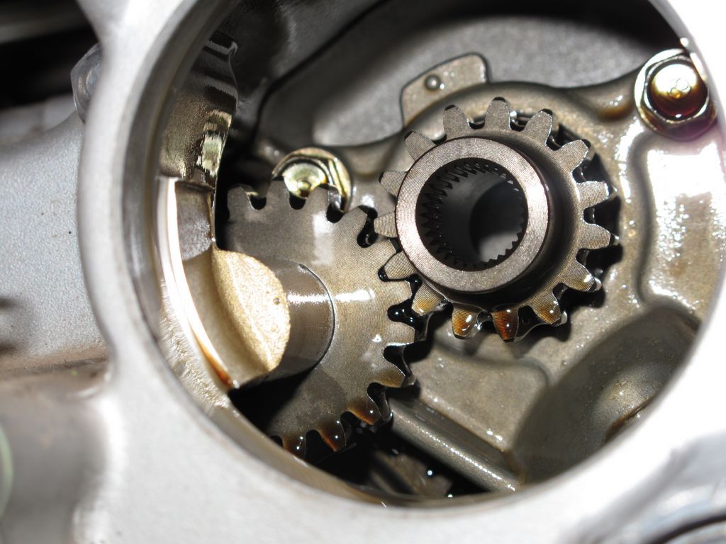

Finally got a day off from work to do some bike wrenching.
First I charged the battery, pulled the plugs, rocked the bike back and forth a bit, then maybe 2 feet forward - thinking that if it broke a gear, it should put the drive gear on a good spot.  The engine resisted movement about as expected; no strange noises.  Hit the starter...
wheeeeeeeeeee.
Same as I left it a few weeks ago; the starter spins fast, no turning over the engine.
Pulled the starter.  What a 2 hour pita that was...
Good news - ain't nothing obviously broken:
Not so good news: so what the heck is it?  Have not found one thread on a starter failure per-se.  Guess I'll pull the starter apart next; maybe hit it with 12V before taking apart.  Gear splines look good, both on the driven gear and the starter.  Tried to turn the starter by hand, and I can't rotate it.  Picked up a spare starter from a forum member, but seems I left it at work, where I have my parts delivered.  Sigh.

« Reply #7 on: November 15, 2015, 11:46:07 AM »
I know there was a post which I saw a LONG time ago about how-to overhaul the starter. But like you said, there isn't much need for it.

« Reply #8 on: November 15, 2015, 01:38:04 PM »
There is a planetary gear reduction in the starter, possibly it has failed. If so best choice is another starter.

« Reply #10 on: November 15, 2015, 05:49:44 PM »
Honda manual says its a faulty starter clutch, or damaged or faulty starter motor gears. Let us know what you find.

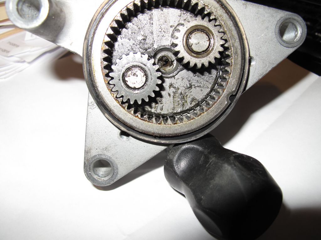

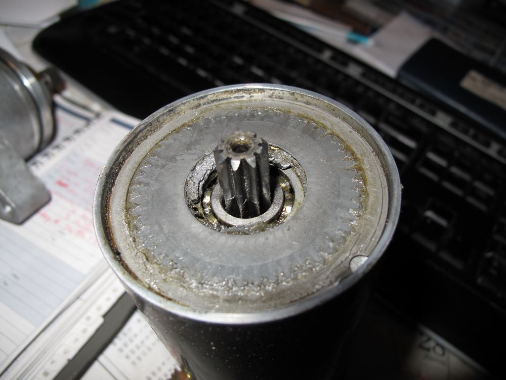

« Reply #11 on: November 15, 2015, 07:45:53 PM »
Funny guy - wish I was clairvoyant -  would make riding to work a lot easier knowing what stupid driving trick the cagers are gonna pull next.  Good idea on the Molson though... Grin  I picked up the starter as I was just playing the odds - as I had a new fuel valve, and had just rebuilt the carbs, and I test the fricken valve every time I ride the bike, I refused to believe a hydro could occur.
Powered up the starter sitting on a bench ,and it spun right up.  WTF?
Took it apart, and aside from the center gear teeth looking a little razor edged (not blunt) , could not find anything obviously amiss:
the planetary set looked ok as well:
Maybe the tolerance is off between the center gear teeth and the planetary?  Yhey sure do not look like a matched pair.

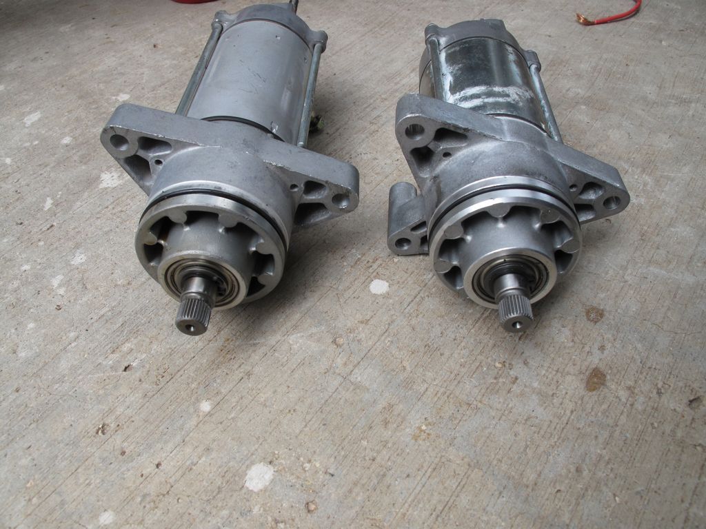

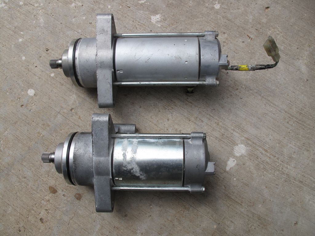

Did not want to ride into work (50 miles one way) and get the spare starter I bought; so as trying to remember where I put the duct tape (to cover the empty starter hole), I remembered that I bought an F6B starter as well - this is for the "Magnum Valk" (GL1800 motor in a Valk frame) project I am working on.  I needed a starter a bit shorter than the 2003 1800 starter to minimize cutting a frame member, and the pics on ebay looked a bit shorter - it was, by 1/2".  Turns out, it is also a perfect match for the Valk starter, and a full 3/4" shorter as well:
Bolted it in (note that it also went in a lot easier than the Valk starter came out), hooked it up, hit the starter... nuttin.

« Reply #12 on: November 16, 2015, 06:32:02 AM »
If disassembled you will find the clutch mechanism within the large end you removed from the
motor assembly. It lays between the planetary gear assembly and the output shaft that you
see, which is the shaft that inserts into the motor gear.

« Reply #13 on: November 16, 2015, 12:48:28 PM »
So is it possible for the output shaft to turn while sitting (unloaded) on a bench, but once bolted up to the engine, just the motor turns, with no output rotation?
It would appear so, based upon my observations...  thanks for the heads up; I'll pull it apart further and see what happened.  Although it's more of an academic question now...
