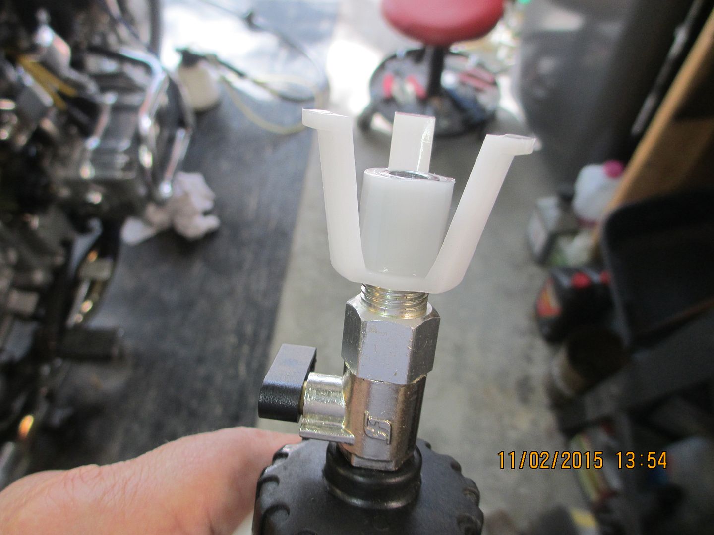

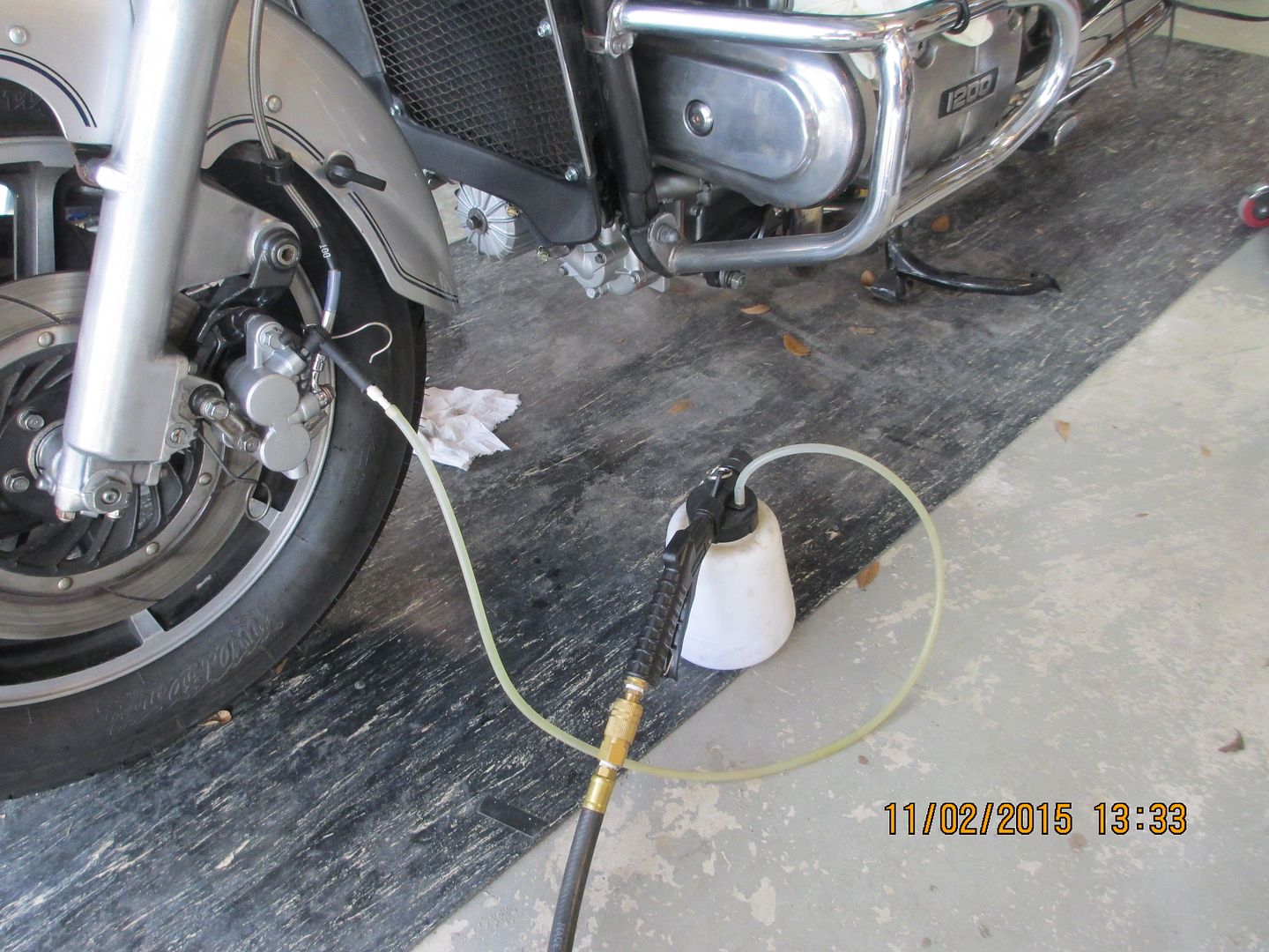

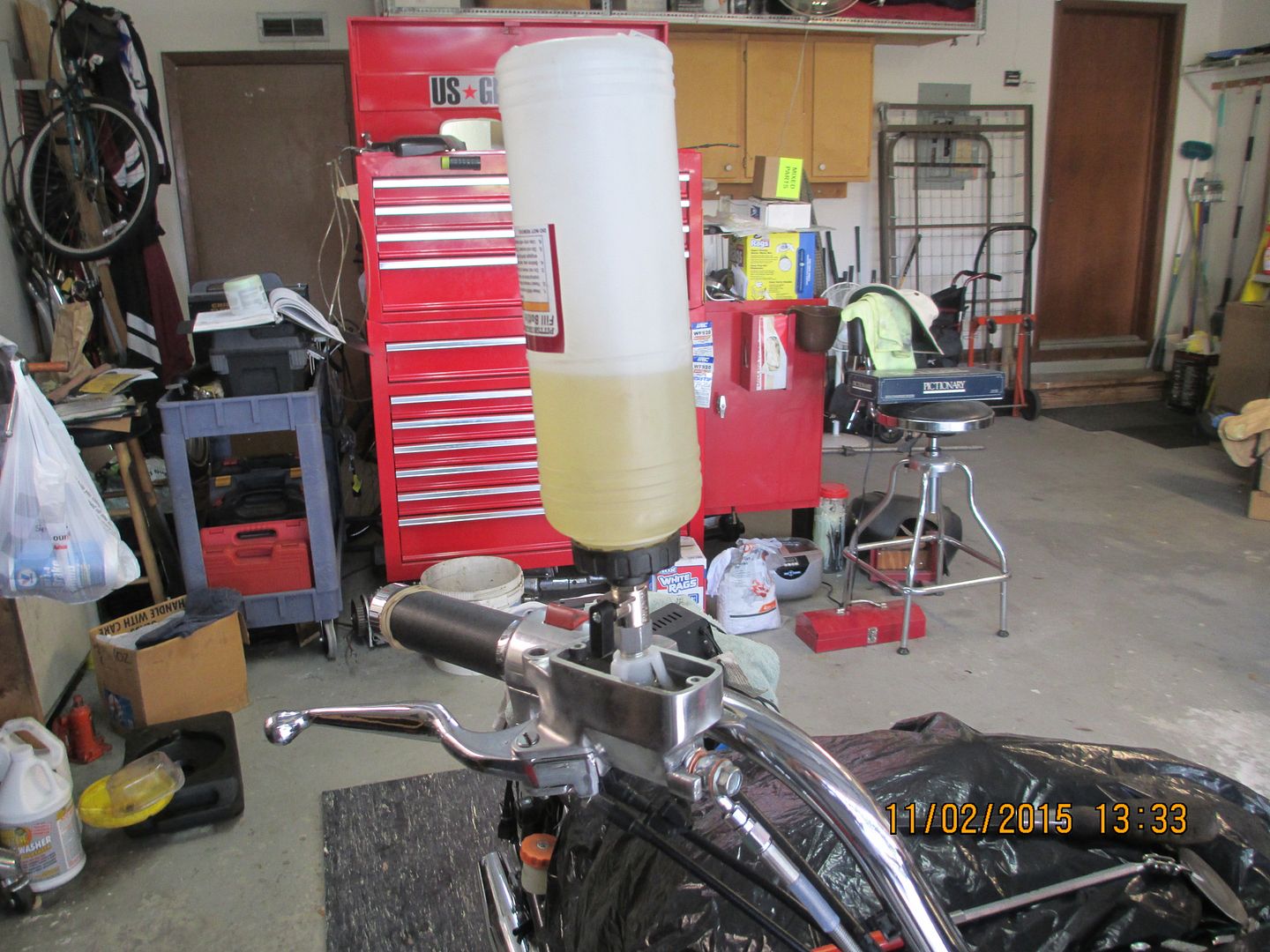

OK, this is the doodad I was trying to describe, most of you have no doubt seen something similar. After sucking nearly a qt. through the system(again), I'm still getting air and no resistance on the handle. I'm about ready to toss all the parts involved, both rebuilt and new, and start all over.
By running the plastic feet up/down, you can adjust the level you want it to start refilling the reservoir. You open that little black knob after you set it in the reservoir and it will blip, blip, blip as the bottle allows fluid to replace that which has been displaced. Keeps you from having to keep checking the fluid level, does it automatically.
Normally, you can lock down the handle and let the air flow freely. Then just sit and watch the brake fluid pass through until you don't see any bubbles. Close the bleeder and move to the next one. This never stopped with the bubbles.

« Reply #10 on: November 02, 2015, 11:45:34 AM »
Some thing I have ran into a couple times is air being sucked in around the bleeder threads. The trick I used was to clean around the bleeder and with it open, put a little silicone around the outside of the bleeder and let it sit long enough to set up some.  That will stop the air from getting past the threads.
We had some low pressure stuff at the airport that had 28 foot runs on the lines, that was the best way we found to suck the fluid through, with out the silicone, it just sucked air around the threads. After you finish, just tighten the bleeder and the silicone will be pushed off.
