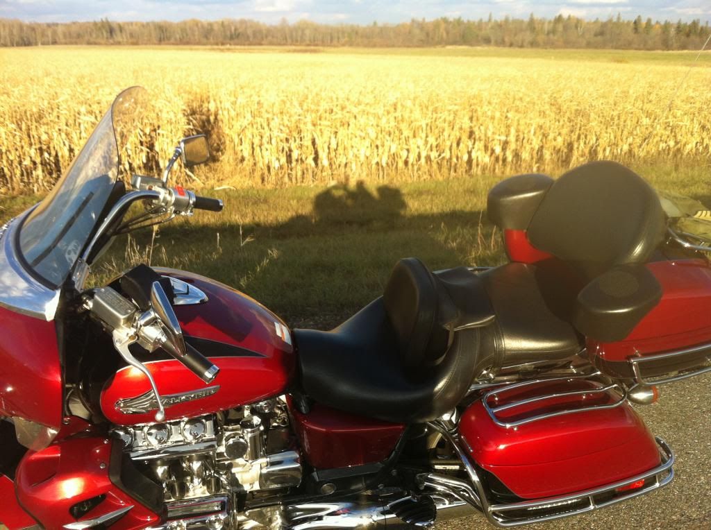

Wolo as well, next to the fuel selector under tank. Easy install, inexpensive, and chrome to boot.  There are different model numbers now but just go to eBay and pick one out.
        The one I have on my I/S is a chrome Wolo mounted pretty much in the same area as this. da prez fabbed up a bracket for me and the sound WILL git yer attention.  cooldude RIDE SAFE. P S-I can fart louder than the stock Valkyrie horn.  Roll Eyes
