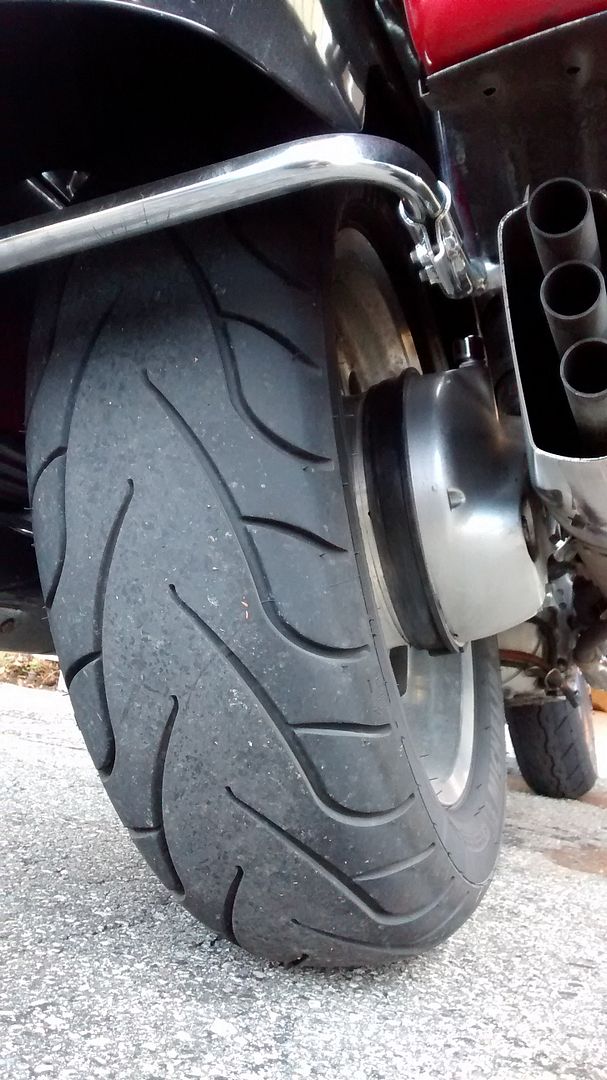

    Hey guys, my rear tire has become a baloney skin so must replace. Avon Cobra or Darkside, yesterday I got views on both from very experienced riders. Some of the guys that have switched to the Darkside swear by them and would not switch back. Some have gone dark and did not like the way it felt and switched back. I'm 64 and not knowing what to expect from car tire I ordered an Avon Cobra. Would like to hear from anyone running this tire and from others that have switched to the Darkside and what brand they prefer. Not getting tire until Wednesday so not married to it but comfortable that there won't be any surprises. Can an old dog learn  Undecided Undecided.
  Thanks for your input

      Thanks for your input guys, sounds like if I go DS then the Att is clearly a great choice. If I go with motorcycle tire the Avon would be a good choice. I ride about 4,000 miles a year so the taxi tire may be the last tire I would ever need. It was mentioned by one member that if I'm a low mileage rider then stay with motorcycle tire so on that I'm good either way. Thanks guys for taking the time to share your knowledge and opinions.  cooldude
