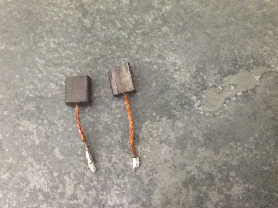

I had an alt. go out a couple years ago. just now took it apart to examine it. Obviously these brushes need replacing, but does it hurt or ruin the alt. if it was run this way for a 100 miles or so ? Or is all i need to do is put brushes in ?

Those brushes pictured actually don't look that bad to me. Yes they are worn, but not to the point where there
would be damage occurring to the armature. There is still a lot of miles left in those brushes. Naturally, now that
they are out, it would be foolish to not replace them with new brushes. Any rebuild shop will have these brushes
and they are very inexpensive. There is nothing special regarding these brushes, and they are a very commonly
used item.

Judging from the picture, it appears the brush on the left may have been stuck and not making contact....or good contact.  It doesn't look to be as worn as the one on the right and may have been your only problem. Dust from worn brushes causing them to stick isn't a new problem. But since you have them out, I'd still go through the unit completely.

Interesting ! I assumed they were as wore as they get. Shows how little I know about alts. This is the first one I've ever took apart. In the past I've always just got a new alt. When this alt quit it was extremely cold and snowing. Do you think the brush just got stuck and quit producing juice ?
That is exactly what happened to mine. 63K miles, and they got stuck. Cleaned, and they are still working. I bought spares, but will do it sometime in the future, maybe even this year.
