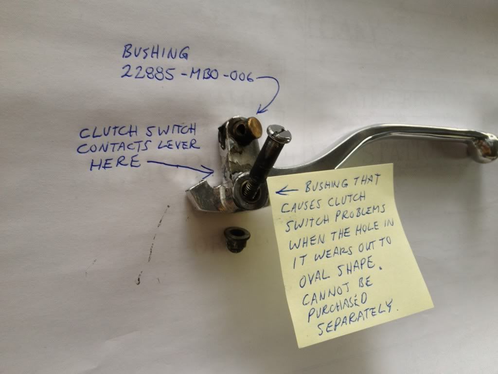

If the handle won't go all the way to the grip, it is a sign that the pressure plate inside the clutch is losing rivets...separating.
However, some other problems you described sound like a worn bushing on the handle itself.  I would change that first, see what you get.

What Chris was suggesting was the pivot "bolt" of the lever could be oval, and no longer is positioned correctly. You can search for that one, there is a nice picture somewhere (I'll look too).
This can also show up on the switch on the lever not being engaged.
