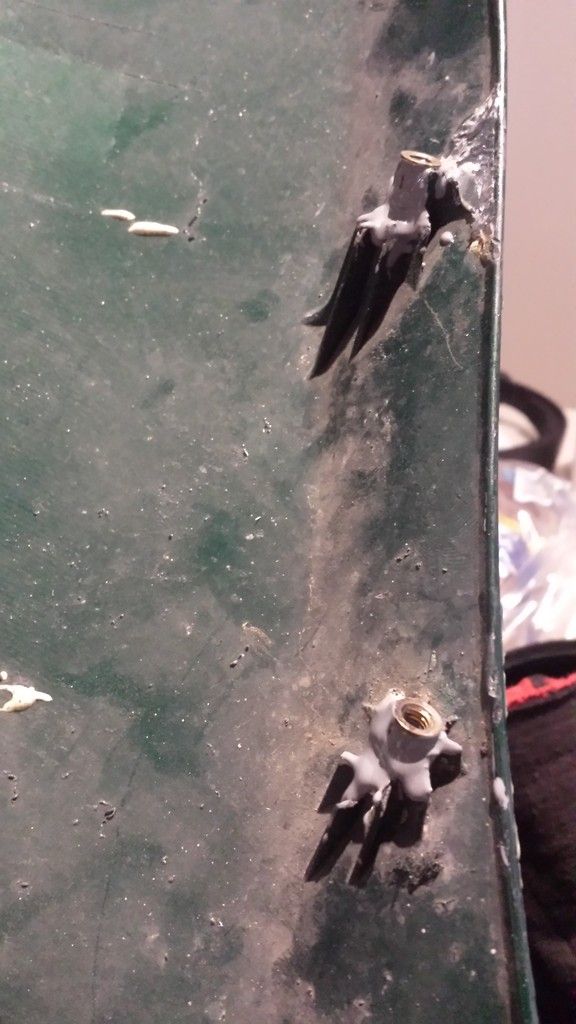

An old post,  but I looked over others to see if there where any pictures. Thought this would be the best one to add mine onto.
Had only 3 inserts holding. I thought I was going to have a hell of a time fixing, as a PO did a "nice" job on fixing it before. No screws, zip ties, wood screws, and a couple of OEM.  :'(
After an hour of scrapping the old fastening material (NO clue of what kind of s%$T was used  tickedoff ) out of the holes, and from the inner fairing, in the end, ALL the holes had at least a little of the top of the hole still there, and each would hold an insert. What luck!
JB weld, a little in the holes, and in go the inserts. The ones missing half their support, inserts in, and build up the outside with left over epoxy. Waiting for it to set (4-6 hr), then put the fairing back together and onto the bike.
