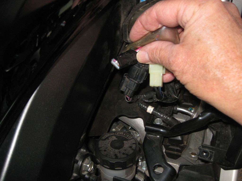

Hey guys after a little searching can't find info for switched power under right side cover.
I do remember reading about an acc tap under the seat. However, I'm mounting the outlet in the right side cover and if possible get switched power right there.
This outlet will be used only for GPS and (or) radar detector. I have a BMW type plug mounted on the left side cover, direct to battery with in line fuse, for heated gear.
Any help would be great, thanks.

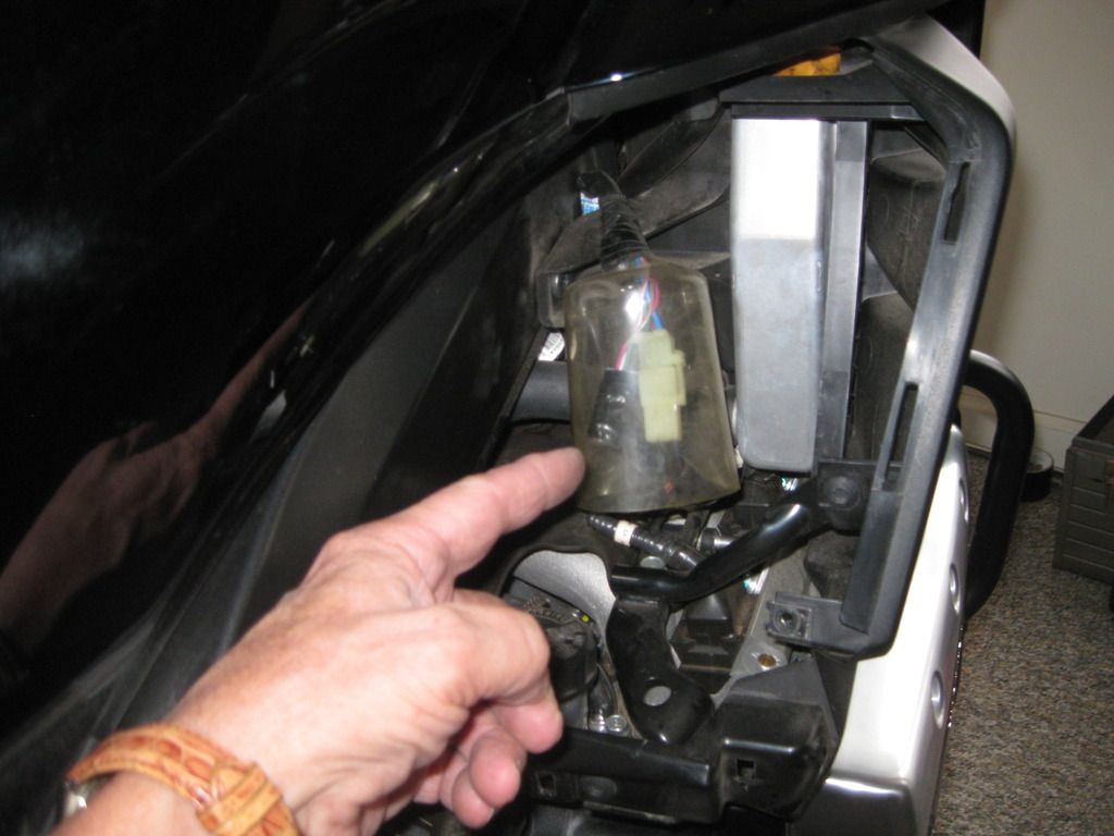

Here are two pics..
Here is what's under the clear boot.

I can do what was suggested BUT my main reason for posting was; "if possible I want to get switched power right there"...
Anyone have any idea what the off white plug in my picture is for?

I just looked at the wiring diagram for our bikes, and it looks like it is for the front brake light switch.  It is the only thing on the wiring schematic with two black wires.
