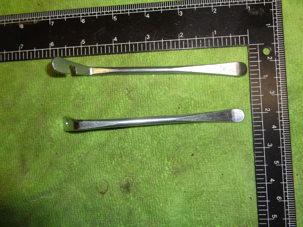

  The last time I tried using some bicycle tire spoons (screw drivers would put a hole in it) and things went pretty good.  I also use the alcohol hand sanitizer for lubrication.
