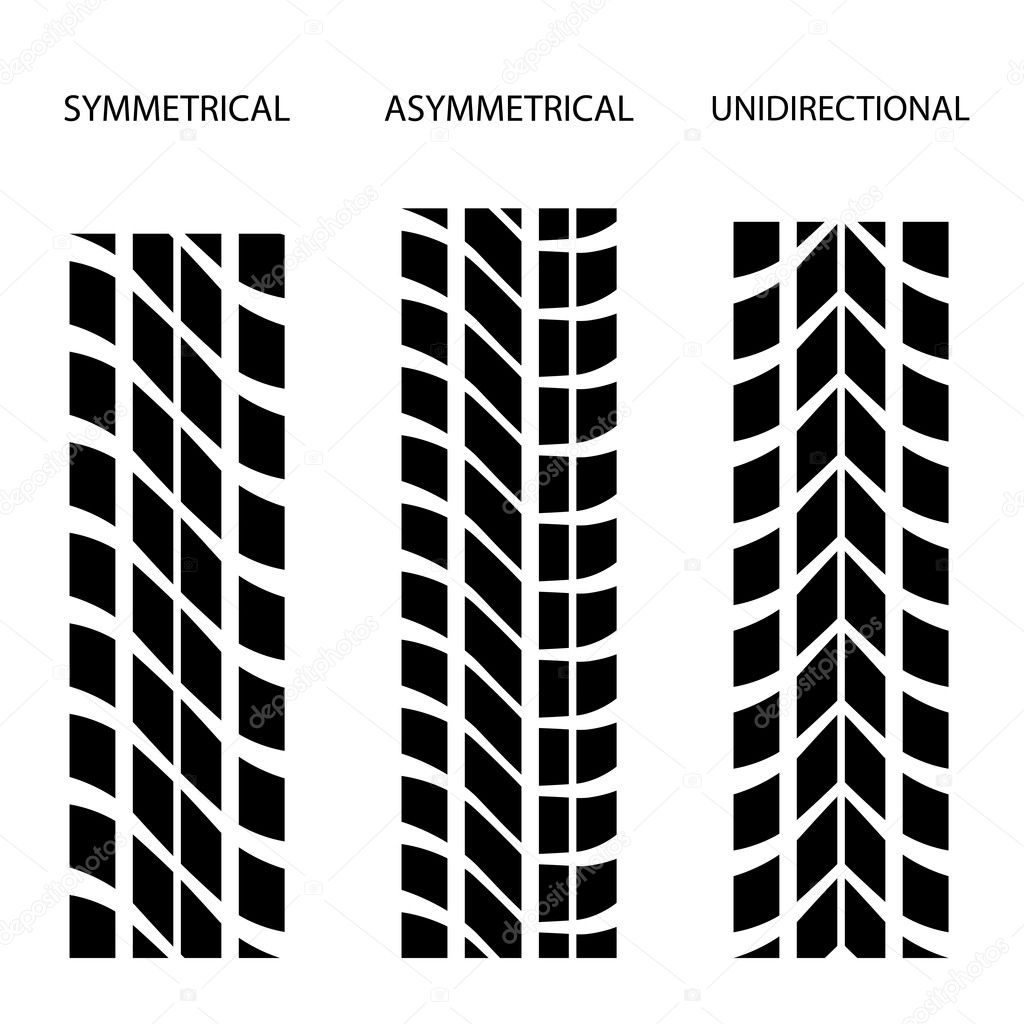

Britman had mentioned Definity HP100 a while back so I wanted to see it first hand. Pretty good looking tire with a rounded shoulder. Did some looking, found they're made by Cooper and from what I can tell have a fairly decent rep. for well under $100. Might give it a shot. For those in the know...what is meant by asymetrical vs. symetrical tread pattern?

The tire you are looking at is symmetrical.
Rio Wil
Posts: 1370
« Reply #2 on: February 12, 2016, 07:15:16 PM »
the unidirectional is the symetrical thread, the other two are asym....
sym....means the tread pattern are mirror images of each other

« Reply #4 on: February 12, 2016, 08:08:04 PM »
Apparently not in tire lingo... symmetrical means there is no specified inside and outside and a wheel with that tire can be used on any corner of the car, assuming it's the right size.

As pictured in GR's diagram, I've had car tires both Symmetrical and Unidirectional.
Could barely tell the difference on my valk.

« Reply #7 on: February 13, 2016, 06:36:53 AM »
John,
I've used 2 different symmetrical tires on my GW, it works just fine. Like already stated, it is a mirror image, when looking at the tread, spin the tire 180* and it will look exactly the same.
I would not use an asymmetrical tire on the bike. It may not make 2cents worth of difference, just don't think I personally would use it.
In the picture of tread patterns...the one shown as "unidirectional" is actually a directional tread pattern. In tire lingo I've never heard of unidirectional, if any tread description of "unidirectional" fits a tread pattern it would be the symmetrical tire.

« Reply #8 on: February 13, 2016, 10:11:17 AM »
Yeah, I was thinking about this whole tire lingo issue when I bought new tires last year.
Technically, two of those tires are symmetrical.
Notice that the "symmetrical" tread in the pic would look exactly the same if you flipped it 180 degrees. In math terms, that's "rotational symmetry". You could mount the tire in either direction and it would look and perform exactly the same. The "unidirectional" tire is an example of "mirror symmetry".
That one is likely to make you hydroplane if mounted backward since it will suck water under the tire instead of pushing it away.

« Reply #9 on: February 13, 2016, 04:20:28 PM »
The idea with the tread being a mirror image, is the tire will behave the same when cornering either left or right. If the sipes on one side run (for lack of a better description) back to front and the other side run front to back, I think you can feel the difference when going into a curve and powering out.  On my Pirelli P4's which I have a total of well over 140K miles on and which I just love, I can feel just a hint of "mushiness"  "twitch" "wiggle" or something in left hand curves vs right hand......I am thinking that is due to the difference in the direction of the sipes and how the tread blocks contact the pavement.
Note in the Pirelli photo the sipes and rain grooves are much more pronounced than the tire you are looking at and I only have a hint of something is not the same left to right......maybe even be my imagination..... crazy2
So bottom line, I think that tire would do well and the sipe direction is so almost the same, you won't know the difference.
