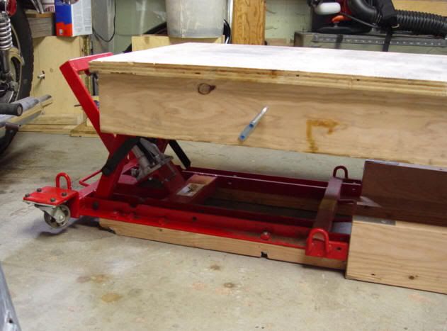

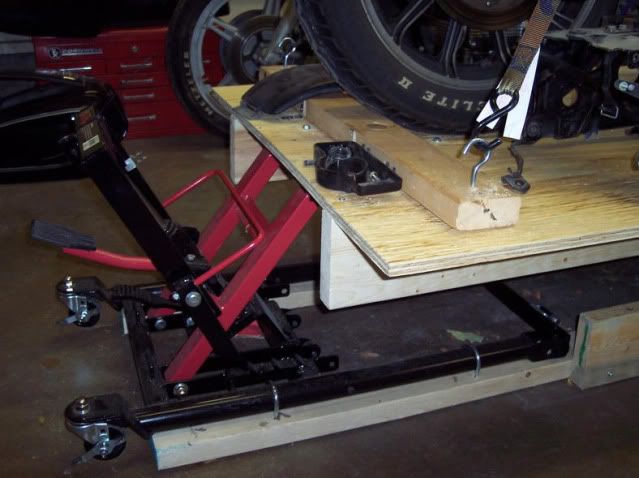

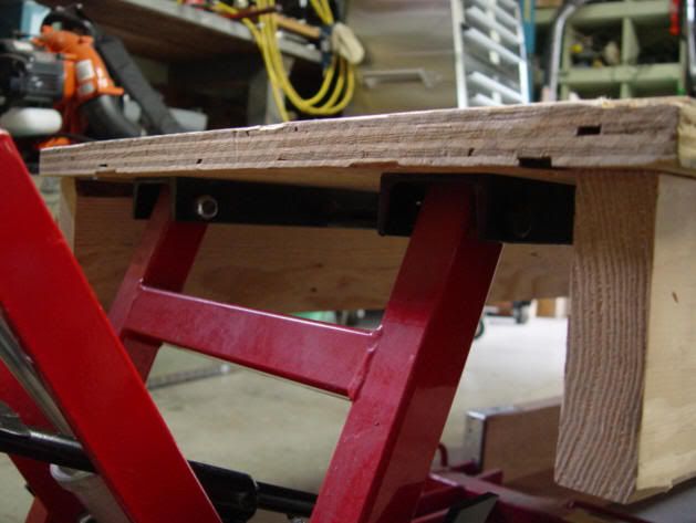

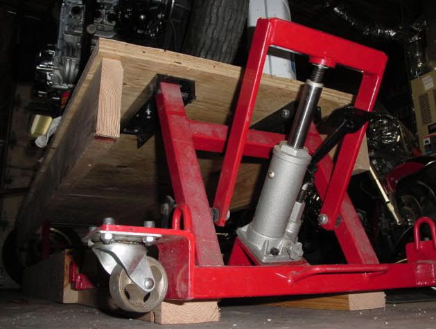

Over on the NakedGoldWings site where I'm also a member there was a posting about making a lift with a "Cheap" bike jack. I thought I would share it with you all.  Also,  it should work nicely with the Harbor Freight wheel chock that seems to be popular on this site ....

Very interesting idea.  A few questions, which you might not be able to answer, since you state that you found it elsewhere:
1) That's not a wing up there.  Any ideas on how it handles more weight than the ~500 pounds that is up there?
2) More importantly, how in the hell do you get it up on that platform?  I suppose you could build a ramp out of the same plywood the platform is made out of.
3) How stable was it?

It is an intersting idea and seems to work in those pictures.  However, I noticed that the jack used is a bigger jack than what you might get at Sears or HF (have seen those before.... can't remember the name right now).   Harbor Freight has Bike Lifts listed for 299.-350 regularly and sometimes even cheaper on sale, and even less expensive when you use the 20% off coupon.  I had one, that I got for close to 200.00 NEW after sale price and coupons, and it worked ok... but it ended up being a parking pad for one of my bikes and it takes up quite a bit of room, so I sold it.  I now have (2) HF MC/ATV Lifts that take up less room, and are more functional for me at least.   I also have a HF bike dolly (that isn't made anymore) that you lift the bike on and can move it around the garage all winter etc.

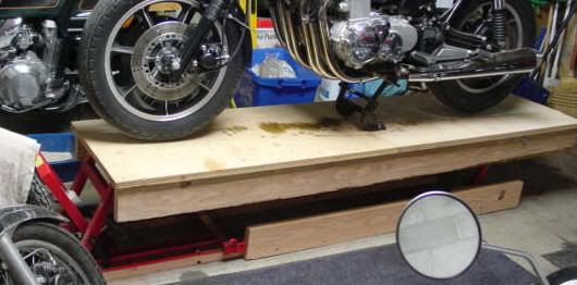

Here's a pic with a Valk on it ....
Obviously the lift will be lower when the lift is down and yep, you will need to build a small ramp.
How stable is it ??  I couldn't really tell you but there where no complaints from the post

I have another question; What is the advanage of this over a $55. adaper, a $70-$80. Sears jack. Seems to me the bike would be easer to service / repair on a Sears Jack I.E. , replace tires, ect. ???

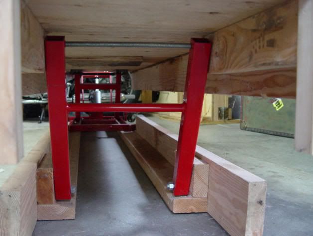

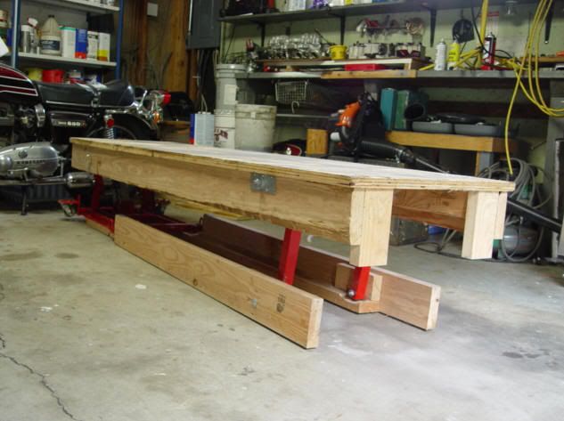

this is my friend's........but it does take a lot of room, and he has it in his shop

But call me a pessimist. Especially with the last one. The base is so wide I would either strain my back leaning over it or fall off of it.
