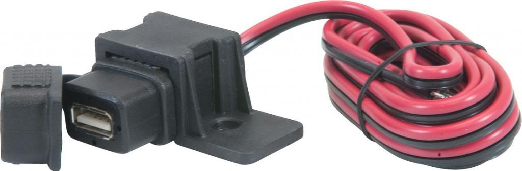

Here is a USB port I used for over 2 years.
I was looking at those cig and dual USB port on ebay that I could mount inside my fairing, but never got around to it, as I needed a cig port for my dash cam (8 hours recording, on/off with power).
« Last Edit: February 18, 2016, 07:58:37 PM by gordonv » Logged
