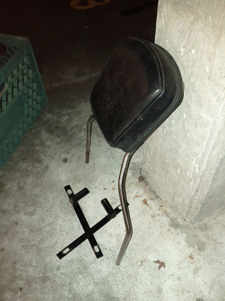

This has been the only one I've seen for the Valkyrie that doesn't need modification of the OEM seat.
I still have this in my parts. It has a bar, I think it bolts onto the two fender rail bolts. Then two tubes that the backrest sits in. Easily removable for passenger to mount, and then put it back in, and drive.
The one I am talking about is similar to this one but the mount is one piece and all chrome and has a bigger curved type rest on it. A friend of mine has one on his IS.

With the Utopia you DO have to cut a small slit in the seat..... they supply a "cap" that covers it....I have one on my IS seat sitting in the Garage... I have a solo seat that I use now that uses a different bracket to support the Utopia..... I had to prove I already owned a Utopia backrest before they would seek me the different bracket.... they wanted me to buy the whole kit.. go figure... the bracket for the I/S seat attaches to the seat base... the standard mount attaches to the fender.... So if I wanted to put the I/S seat back on I'd have to remove the other bracket. Thats why I have the I/S sat sitting for the last several years...
For the value the Utopia is the best.. I think you can get one for about $160... the other one is almost double, plus the bars sometimes hit you in the hip.. At least the one on my Wing did....
