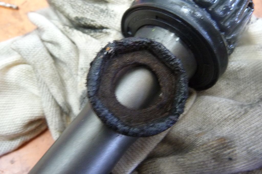

Thats why I was experimenting with this.....a felt washer saturated with lube......
not sure it helps.....or hurts......it has been in the pinion cup for 30K miles so far... crazy2

« Last Edit: March 08, 2016, 09:17:00 PM by Rio Wil » Logged

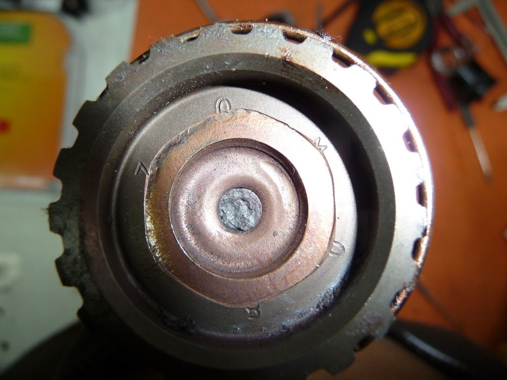

Well, I just found this picture in a post from Squealy on April 2013, and the outside circumference of the driveline does not show evidence of metal to metal contact, but then again, neither does the center where we know there was contact.

« Reply #13 on: March 10, 2016, 08:03:03 AM »
Pretty evident the polished area on the end of the drive shaft in the center. The other part concerned is not pictured, and that would be
the end of the pinion gear shaft. The part that the nut threads onto and holds the pinion cup tight.

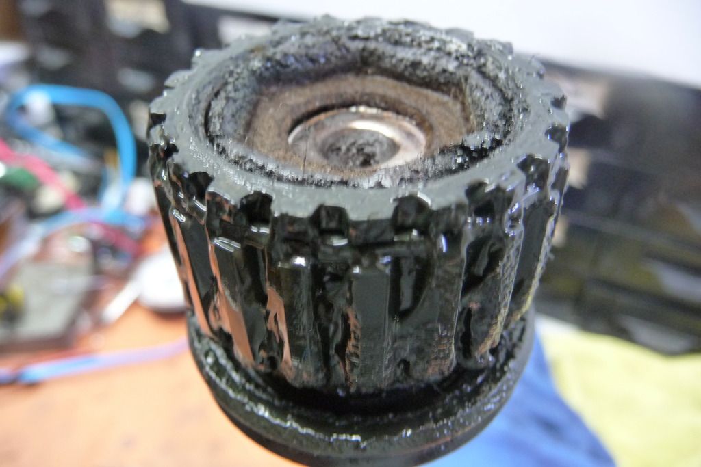

Ricky.....to your point, here is a photo of a drive shaft mating surface and of the pinion shaft and nut.  It is clear to see that not only did the shaft wear off the end of the pinion shaft but also contacted the surface of the nut. The six sided nut is clearly worn into the end of the drive shaft about .010-.015 thou. There was no other reason to replace the shaft and pinion cup in this instance except for the wear. It is also evident that the end of the drive shaft only contacts the end of the pinion shaft (and nut) and no other place inside the pinion cup. As a matter of course, I leave the snap ring installed for whatever reason.... crazy2
My mystery is: for 3-4 maintenance intervals the splines will look great, well lubed with grease (and not from the final drive fluid) for 45-60K miles, then the next interval (15K) it will have eaten itself!!!!
I am on my 4th set of shaft/cup.....glad the are only about $80 a set......
The rearward pressure the drive shaft exerts on the pinion shaft is from the spring on the front of the driveshaft where it enters the ujoint. When mating the final drive to the swing are, the amount of spring compression is evident when the drive is almost fulled mated....about 1/16 to 1/8 inch compression of the spring. That doesn't seem to be a lot of pressure but there is evidently other forces acting to exert significant contact to induce abnormal wear (aggressive acceleration-high speed driving-aggressive gear shifts.....)..
Eating a shaft/cup set every 60K miles or so is tolerable.....but it is curious why some never have a problem...
Just to be clear, I don't believe the "red rust" to be from water intrusion, but from the contact of the drive shaft/pinion shaft and generating enough heat to bake the lubricant to the point it starts to grind off tiny metal particles and left to continue it will creep out to the splines of the shaft/cup and eventually produce the results pictured in another post below..... just my .02...... tickedoff

That is pretty much what this is all about, after following the "Honda lube protocol" we still ate shafts and cups so we launched off into other solutions.  That might be a worthwhile survey to see how many have opened the shaft/cup and found any evidence of final drive fluid....

I have learned this much,, the depression from the pinion gear shaft, in my drive shaft is .022 deep.
If allowed to continue for another 70-80 thousands, both the nut and (in my drive) the outer circumference of the drive line will both have metal to metal contact. If that would cause the observed meltdown of those part, I don't know, but I will be monitoring the depth of wear in the drive line every time I take it apart in the future, and be molying up those surfaces. I may make a nylon bushing and give it a try, but on a new drive line.    Rio, I wonder if that drive shaft that the nut had contacted, how deep was the depression from the pinion shaft? and was this a case of red rust when disassembled?
Never mind on the red rust question Rio, I guess the picture of the cup is the one involved.
Also, in my opinion, the only time you will get gear oil into the pinion cup is when the final drive is overfilled, and that the holes in the pinion cup are for pressure equalization.
« Last Edit: March 10, 2016, 03:24:39 PM by pancho » Logged

Well, looking at that picture of Squealys' again, it looks like his shaft wore to the point of the nut having contact in the cup.

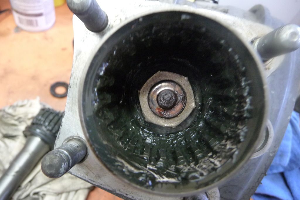

The depression in the drive shaft is about .070-.080 deep......the drive shaft with the nut impression is the shaft that wore the pinion shaft. The cup in the photo full of grease is a new one that I checked at 5K miles to see how it was doing, the new drive shaft with 5K miles on it is laying on the work bench.  I also put the felt washer in with this drive shaft and cup at the same time. This shaft/cup/felt washer combination has about 30K on it so far.

Rio, does this picture show that the end of the pinion gear shaft itself is being worn away? I can understand monitoring the wear on the drive shaft and replacing it when it gets to a certain depth, but the pinion gear shaft seems to be eaten away also. At what point do you replace the final drive also.
In an earlier post I suggested that the ring and pinion gear are surface hardened to a specific depth. When that thickness is eventually worn away, the wear would be at a much faster rate.
Any thoughts on this?

Rio Wil, I certainly agree with you that the wear you pictured is extreme and abnormal, and not something that should be expected.
I can visualize several scenarios where this might occur and they all start with contamination. This is the main reason for the seal
between the shaft and the pinion cup. Of course, the only reason for my post was the unnecessary needing to replace the clip to which
is evident the clip would not prevent the wear you have pictured.
I think you are right about the drive shaft and pinion shaft being surfaced hardened, but I also think those parts are probably forged which adds toughness (I think...but I am no expert on that).
After replacing the shaft and cub and installing the felt washer, there doesn't see to be any addition wear on the pinion shaft.  As a matter of fact, it is interesting that the forces acting  on this point of contact are not sufficient to tear the felt up,  the primary force being thrust and only very little squirm of the two parts, just what the spline tolerances allow. Anyway, I don't plan on replacing the final drive for this issue. With the felt there, there is no contact
Mallet.....just curious, are you the gentleman that gets like 27K from a set of tires.  Not asking to be pissy, just wondering maybe about riding style and drive shaft/cup wear.....any correlation?
I am thinking at the next lube interval, I will weigh up the recommended amount of moly and clean up the cup to spotless (as I always do) and give it another go....maybe overfill the final drive by maybe .5 ounce and see if it will lube the splines.......ain't holding my breath :crazy2:h......
