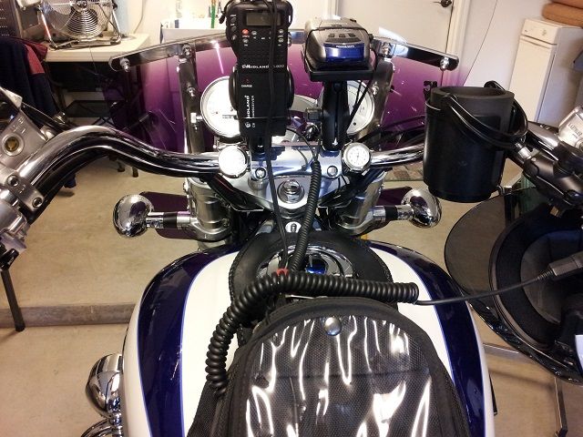

I use the Midland solution and connect it to a J&M integrator so I can listen to my tunes as well as the CB.

Cheaper place for the Midland, which I recommend for those few occasions you might want a CB.  Not sure about that JM integrator tho.
Some folks are using FRS radios rather than CB.  I have both the Midland CB and a Baofeng UV-5R programmed with the FRS frequencies along with others, like WX, Police/Fire etc.  I think there are other similar alternatives to the Integrator, but  I have used an earbud in one ear for CB/FRS radio monitoring, and the speakers to listen to my radio, GPS/MP3.  If I need to key the Mike I either lean forward and key the handset and talk or lift it off my cup holder and pull it to me.  I don't use it all that often, and didn't see the need for the added expense of an integrator......but have considered something similar and smaller.
