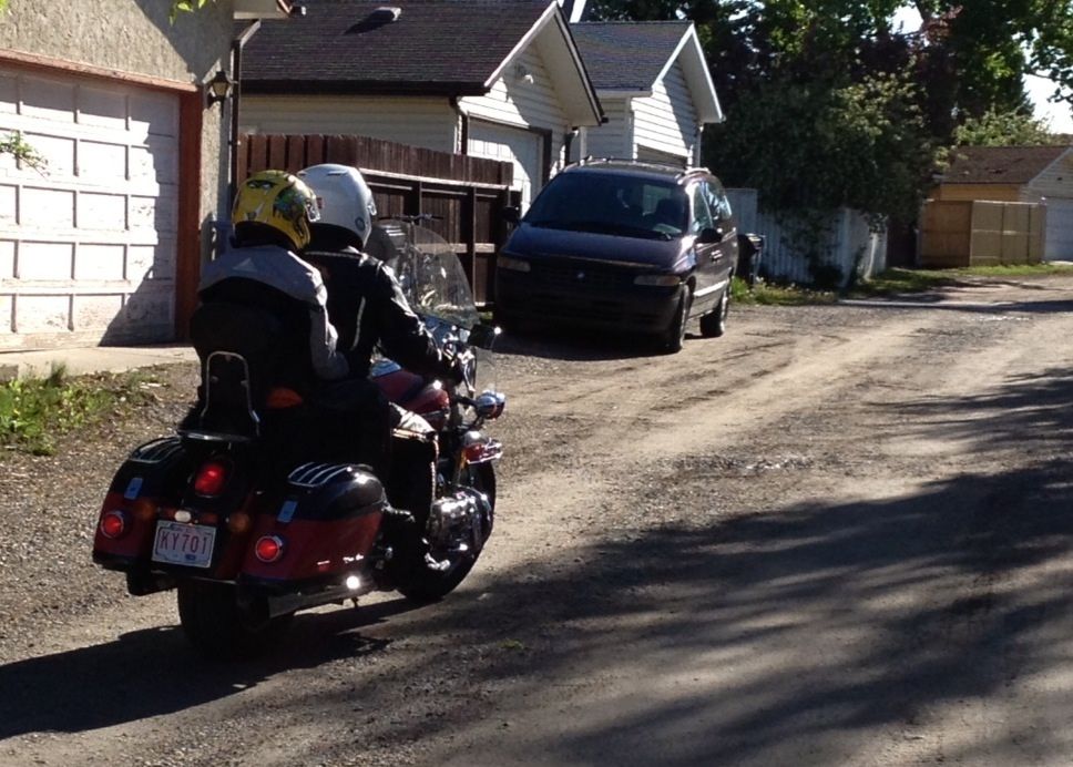

That's why I put running/brake lights on my saddle bags.  More conspicuous, and three lights still say "motorcycle" while giving the viewer an apparent distance between them that grows as they get closer.  Something reflective on the backrest helps too.

Love that set up, where did you get those add on lights?
Gryphon Rider
Posts: 5234
2000 Tourer
Calgary, Alberta
« Reply #20 on: April 03, 2016, 06:00:53 PM »
Gryphon,

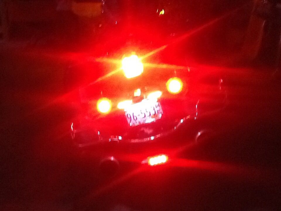

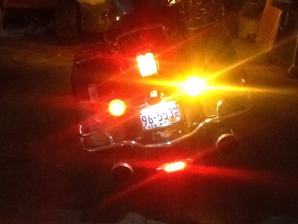

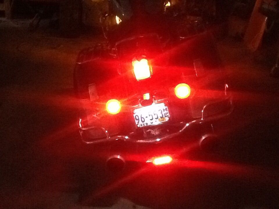

I seldom ride at night but the Valk is prepared to do so.  Over the years I have continued to improve my visibility.  The original tail light has a lamp from SuperBrightLEDs that flashes three times as the brakes are applied.  The turn signal housings have the circular array of LEDs that operate at full brightness for running lights.  A mud flap has another LED array for running lights.  In addition, the reflectors on the saddle bags have been replaced by LED arrays (not pictured).  When brakes are applied, two more LED arrays above the license plate are activated.  All the lights are red, however the brightness in the pictures below have overpowered the camera on this iPad.
Running lights only.
Brakes applied.
Right turn signal.
« Last Edit: April 04, 2016, 10:27:57 AM by BobB » Logged
