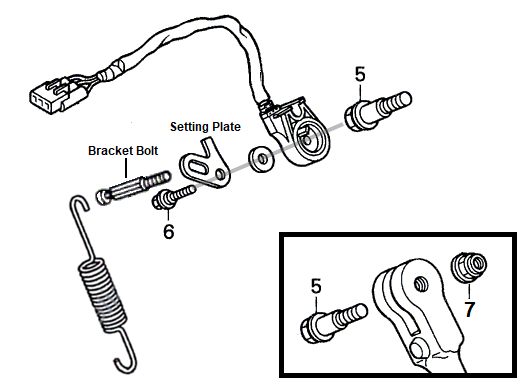

Thanks to all that replied and remember when ordering that replacement bolt.....it's on the the FRAME diagram. Don't ask how I know. Many, many thanks to Mike Frye......went to look at his  side stand to get a better idea of how it is suppose to look.....and he handed me the parts to fix it. Turns out he carries a spare spring and bolt. Parts are OTW Mike.....thanks again !!
HOOK, SPRING
50536-MZ0-010  <------bolt

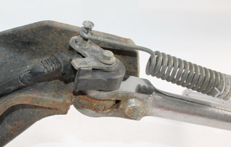

The spring for the kick stand disappeared today, on a ride! When I look under the bike on the right side it looks like something is missing. The safety switch is still there. Should the 14mm bolt on TOP of the kickstand, have another nut or bolt on the bottom of the stand? Thank you in advance!

Oh my was that picture taken from a Valkyrie that was found on the bottom of the sea. Dirt and rust, oh my.  crazy2

maui boy, t'was just a screenshot of an ebay pic. I'm not affiliated with the true owner. Anyways, gangman might have been inquiring about Nut 7, which functions like the nut on the bottom of the clutch pivot bolt, a double capture so on. Oh, and when I took the spring off my sidestand, there was a lot of play on the sidestand. That was a question somebody asked a few months ago, and I stated, nah, there's very little play. Had to remove the spring to work on the clutch slave and found that without the spring tension, the kickstand does flop around more than you'd think.
