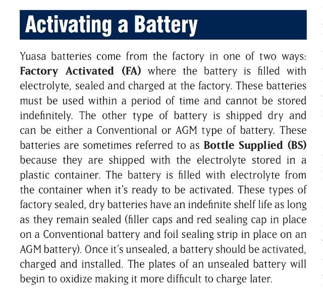

Might want to check that, Patrick! I have never seen an AGM Battery that wasn't sealed. Then again, what da' hell do I know?? Grin
« Reply #10 on: May 13, 2016, 04:47:38 AM »
Well, its a model 14-BS made by Exide.  The battery, the box, and, the instructions all say it is AGM. All I care about is that it starts the engine when I want and how long it lasts. So, I don't really care whether it is AGM or not, but, I'm sticking with the assumption that it is.

All ye of little faith: Even sealed AGM batteries can be supplied with the fluid separate. From Yuasa:

All yet of little faith: Even sealed AGM batteries can be supplied with the fluid separate. From Yuasa:
