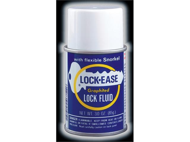

I would only use a graphite lubricant in a lock. Something where the liquid carrier evaporates completely, not leaving an oily residue to attract dirt.
