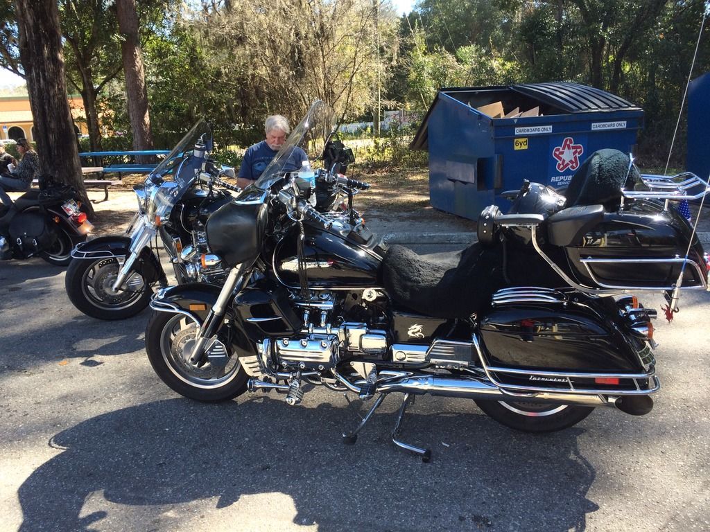

Already double dark in the rear................. Why not go dark upfront on my trike?
Now I run a Dunlop rear mounted backwards up front. Supposed to last longer this way.
But, due to the nature of the trike steering why not do a darkside upfront ......??

I don't know ship about Darkside on the front, but I do know that's a nice looking trike. You should post a few more pictures

The pipes are just installed Mark Ts. Love them!
