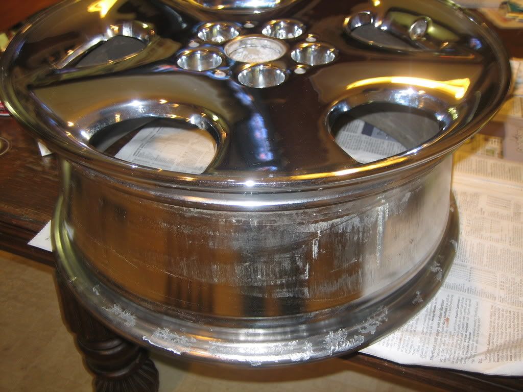

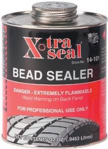

I bought a quart can of X-TRA Seal Bead Sealer in 2007 for $17.20 ($10.95 plus $6.25 shipping). I was having problems with my son's chrome wheels. Locally, O’Reilly currently lists a quart at $12.99.
It does NOT dry up on the shelf. I use it all the time and I am still using the quart I purchased in 2007 (I think maybe even on my Valkyrie the last time I changed a tire). I used it on the front wheel of my Dixon ZTR. The stuff is like liquid magic.
Now, I will confess that I have a cheap manual tire changer, an old bubble balancer, I change almost all my own tires, and I drive and use a lot of old junk. But I have used the bead sealer on at least a dozen tires, all with 100% success.  I do not use it as a matter of course, only if the bead is leaking after mounting the tire. I also clean/sand rusty/corroded rims. If you think you might have any use for it in the future, I would highly recommend  X-TRA Seal Bead Sealer. I know shipping to Canada might be expensive, but I would recommend shopping around and buying the bead sealer.
