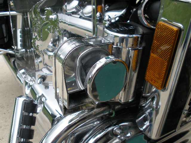

I used a 1/8" pc of aluminum and made a 90 degree bracket and used the upper radiator bolt as a mount. You can see the bracket in the picture. Don't know why photostash turned the pic.
I did this but mounted mine vertical instead of horizontal.

Not an Interstate but I mounted the Big Bad Max horn on my Tourer, replacing the Wolo horn shown in the picture below.
The bracket made from .125" aluminum sheet was complex to make but locates the horn in the best possible position.  It attaches using the engine guard bolt.
