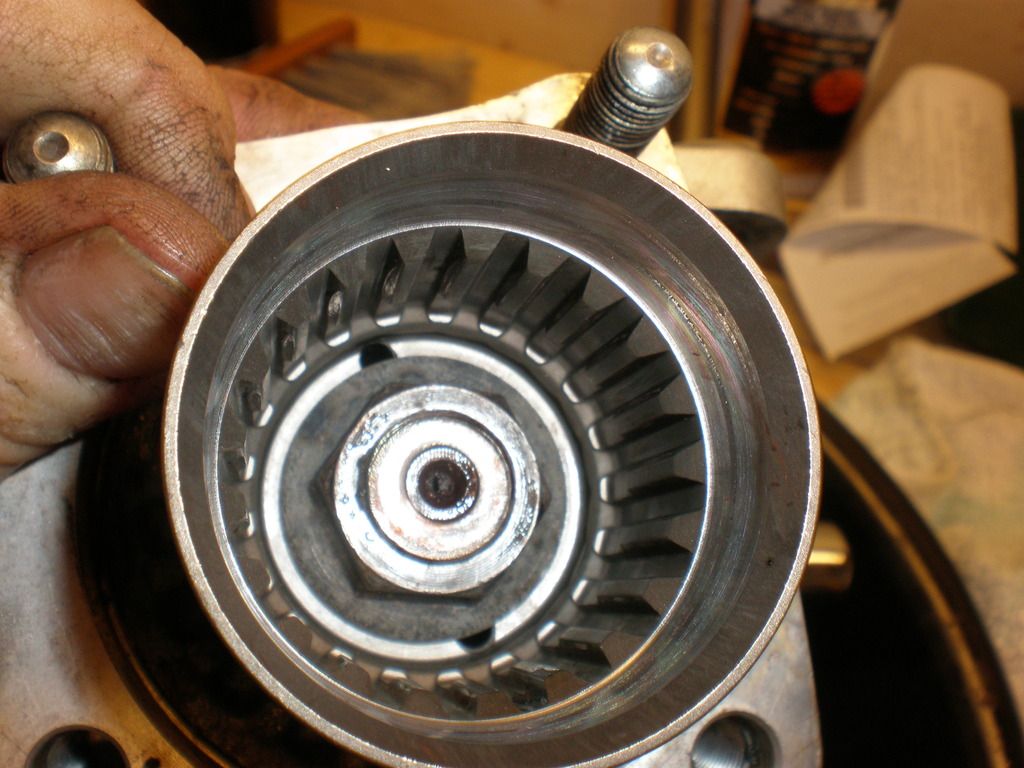

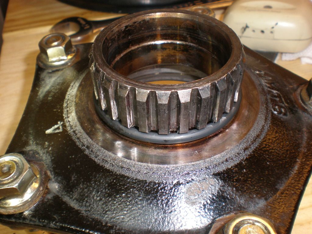

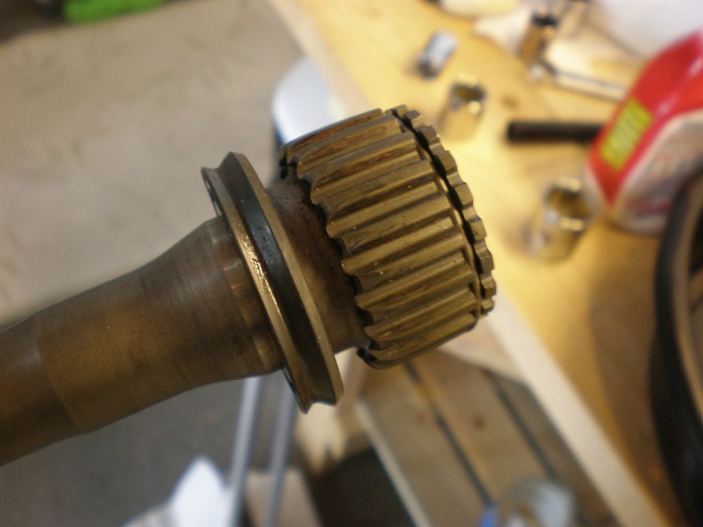

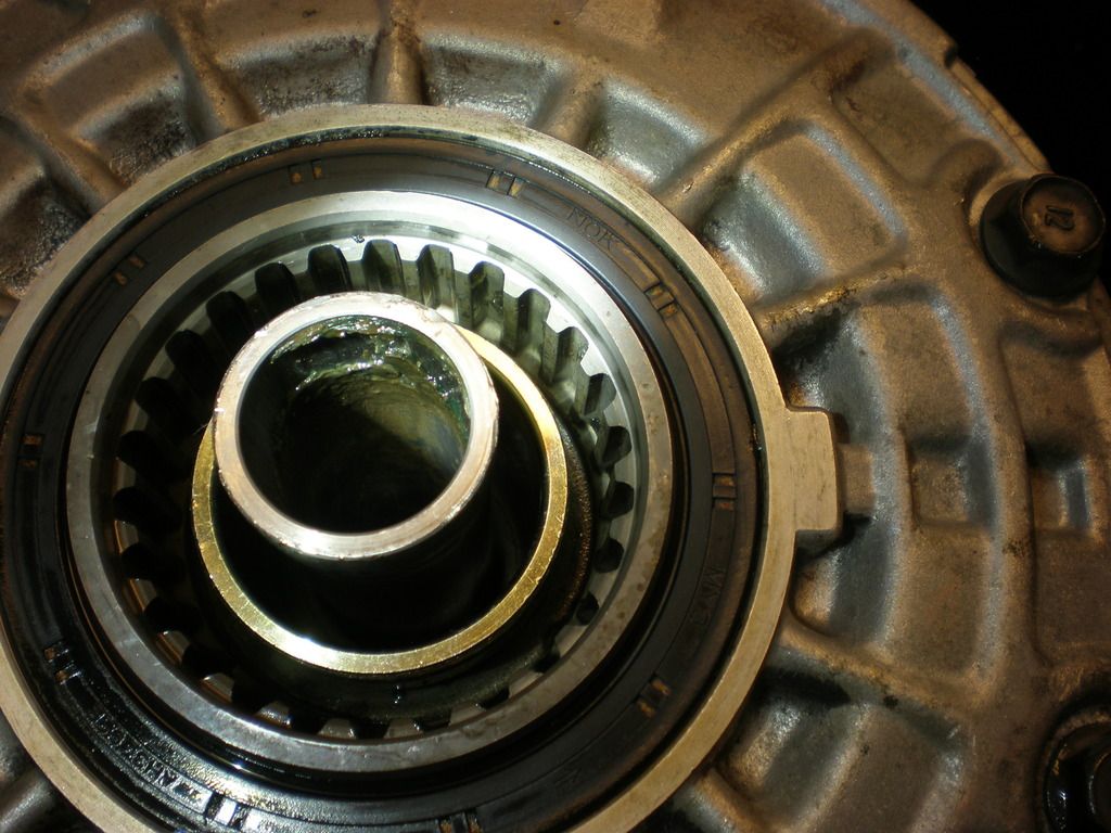

I am ashamed to admit that I had never pulled my drive shaft until today.  (2000 I/S) I don't have any good excuse.  We're going to ride to the UP in mid July and I thought even though I'm not changing out the rear tire, I had better give it a look and see what the damage is to have enough time to get the parts ordered if needed.
(The drive line parts of my Std looks like new.  No worries there.)
I was very surprised.
The pinion cup was wet like it should be.
Dodged a big bullet.
Just a little shiny.
Almost zero wear.
BelRay Waterproof Grease.

I had a similar experience.  I didn't even know the final drive components needed all that maintenance until my Tourer had nearly 40K miles.  When I read about it I got alarmed and pulled it all apart one evening, only to find that everything was in great shape.
I have to wonder if in some cases the frequent maintenance does more damage than neglect.  I'm sure that's the case for the drive splines.  When they get damaged it's nearly always the result of misalignment resulting from torqueing nuts in the wrong sequence.

« Reply #4 on: June 26, 2016, 07:40:44 AM »
Yep, goes to show what the correct lube can do, though nobody should push it that far crazy2.  I went 5k after I bought my bike before getting in there (it then had 33K on it), only to find the PO or his mechanic screwed me--nothing but rust on the splines!
By the way, you say you never pulled your bike apart before 59K--how did you ever change tires without seeing your splines? Shocked

I use BelRay Waterproof grease on the splines on the wheel, what are guys using on the splines in the pinion cup?  On my Std, I put BelRay in the pinion cup.
I won't be able to get back to finish this job until Monday.  Will be out of town all day.  If I need something special, I'll have to wait until Tuesday when the Honda shop opens.

Posts: 13777
« Reply #9 on: June 26, 2016, 03:02:19 PM »
correct lube was not used.  Honda engineers call for moly grease drive shaft, final drive splines get moly paste both with a minimum of 60% moly. I use TS-70 moly.
 excessive wear on the tooth sides can be seen for such low miles.

I think the pinion cup calls for 3% moly grease, the splines call for 60% moly paste.

« Reply #12 on: June 26, 2016, 06:28:39 PM »
I actually think the pinion cup is going to be more forgiving towards neglect than the drive splines because for one thing I know there's a debate about this  but a certain amount of gear lube gets into the pinion cup correct? I put a little bit of Honda moly paste as well as some bel-ray Grease on my pinion cup and there  hasn't been a problem.

Steve K (IA)
Posts: 1662
Cedar Rapids, Iowa
« Reply #13 on: June 26, 2016, 07:30:40 PM »
So you have done maintaince prior to this if you pulled the pumpkin and lubed it. Or am I not understanding?
Went back and looked, I assume you just greased the splines of the pumpkin not the pinion cup.
Correct
States I Have Ridden In
Steve K (IA)
Posts: 1662
Cedar Rapids, Iowa
« Reply #14 on: June 26, 2016, 07:39:35 PM »
Excessive wear?  I guess the pictures don't transate well?  If you seen this in person you wouldn't have said that.  I would give all parts a 99% good.  I'm quite happy with what I have here.

« Reply #15 on: June 26, 2016, 08:05:13 PM »
yeah I wasn't sure what he meant by excessive wear either. My comment about correct Lube was since Steve didn't do any maintenance on his pinion cup, then it's the lube that mother Honda put in there at the factory that lasted him all those miles and years.

« Reply #16 on: June 26, 2016, 10:21:52 PM »
That would be correct also.  Wink
And because of that I think I will use the recommended lube.
