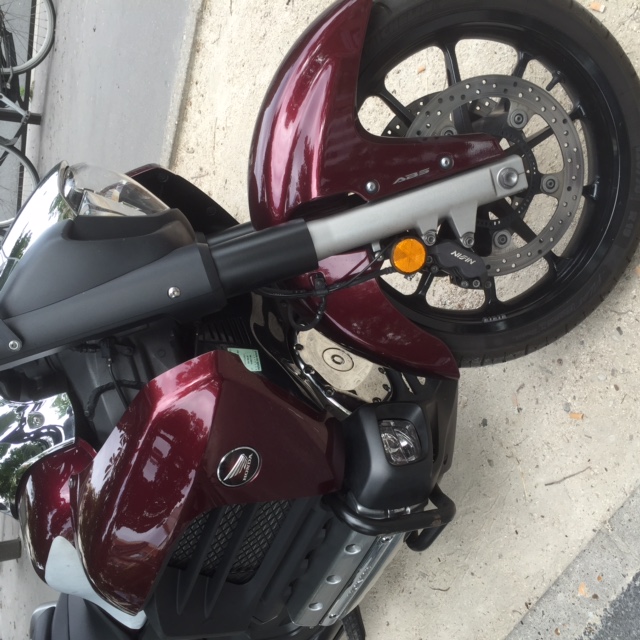

Got the cover today so of course I had to put it on and it fit perfectly. Its a nicely made piece with everything lining up like its supposed to and the finish is good. There is one criticism is that the chrome scratches fairly easily. But it looks good on even though I wasn't sure if I was going to like it. A bit of a pain to put on but nothing serious. The other thing is there is a coating on the inside of the engine. It looks like its painted with black spotted paint but what I think it is, is the coating for the oil not to stick to the aluminum inside of the engine. Its very slick and smooth even though it doesn't look it. Just thought I would report back to anyone who was interested. All in all a 8 out of 10 and for the price its hard to beat. I may take the original cover and have it chromed. Heck its going to cost more to have that done than it did to buy this.

Looks great Robert, I feel it is a great fit for the rich maroon color.  cooldude

That looks sharp Bob... cooldude  What is it made of?

Adrian its made of plastic, Just kidding its some kind of metal, from China  Wink.
Thanks guys,  cooldude You know when you make a change and its different and your really not sure then it kind of grows on you thats this cover. I have come to really like it, there is an aftermarket cover and its just a stick on flat metal cover. I did not want that because I like the looks of the bolts and the OEM look.

Bob, was it that hard to install?  Did replacing that cover necessitate having to replace any gaskets?

I didn't use a gasket but used silicon sealer but I listed the gasket up above. Its not hard at all to install but a bit picky on how its done. The front cover is on dowels on the engine and even with all the bolts out has to be pried off. I opened the center hole and with a screw driver pried at an angle and the cover came off easily. The ignition pickup is bolted to the cover and the wire goes under the front upper cover which I would remove to make things easier. There is not much clearance to the front fender so either a cover on the back half or remove it. Other than those tips its straight forward and like I said the cover scratches pretty easy. A little oil may come out nothing to get excited about though.

If you looked at the parts fiche that I included in the pic you will see number 5 that is the gasket (joint d'étanchéité) and the cover number 4, this cover is part of and replaces (remplacé) the original cover on the bike. I didn't want the cover taped (enregistrée) on which is the reason yours is cheaper and I didn't like the flat chromed look and wanted the accent of the bolts. Your cover is what all the Goldwing guys get because its smooth and chrome and doesn't have that engine or mechanical look to it. I did not want to lose that kind of look on this bike because its like looking at an engine or anything mechanical and seeing the bolts.

I remembered seeing the pic of yours in black and and thought it complemented the accents on the bike. My accents were chrome and so I got the chrome to go along with them. Because you powder coated yours it started me thinking about this, I wish you would stop doing that. This is the second time I had to go out and do something because I liked the things you did on your bike.  Grin Thanks by the way.
