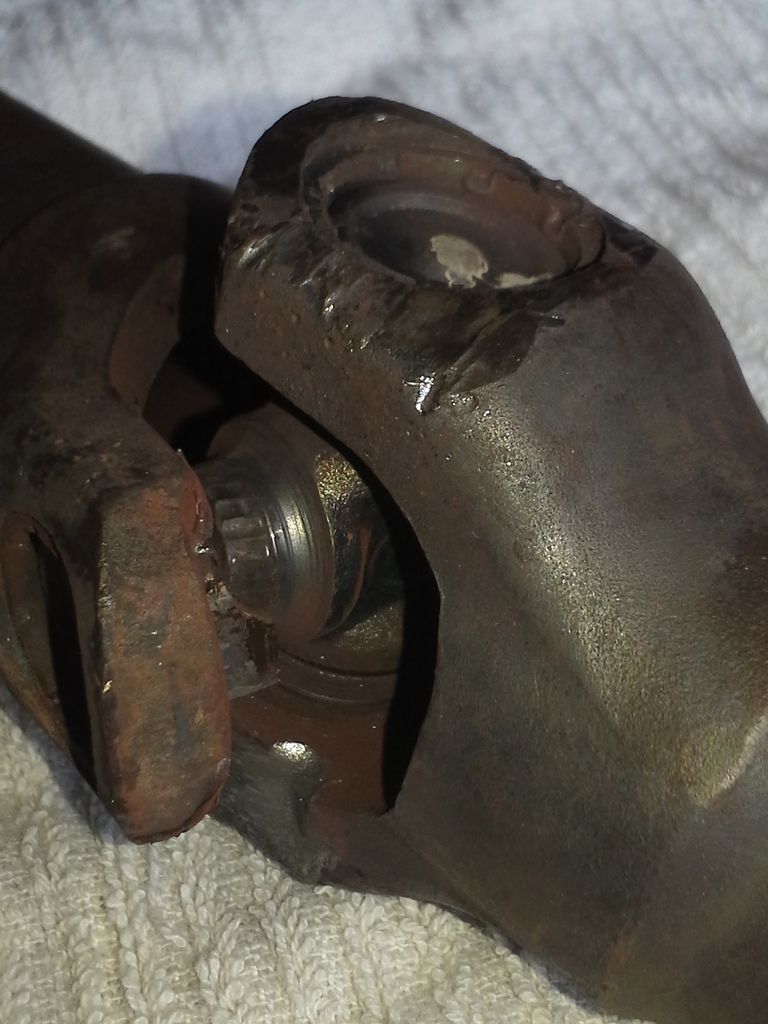

Malta Mt., on the way home from Glacier Natl Park, middle of nowhere, no cell service, been pulling my trailer behind my 2000 Interstate with 138K.   I keep this bike well maintained, however, it starts rattling between 4th & 5th and then gets worse.   Felt like the road was a little rough (vibration) and soon  the only way I could stop the very loud rattling was to be under load, either accelerating or decelerating.   Stopped in Malta, got on the Valk web site...was thinking this may be a clutch problem..rivets, but Meathead convinced me it was probably U-joint or pinion cup.  Could have gotten it fixed, but would have taken 3 or 4 days to get parts, my friends wouldn't leave me and I couldn't hold them up any longer.   Drove 100 mi, got a 10ft U-Haul, loaded up and drove the 1500 mi home....$800 including gas.

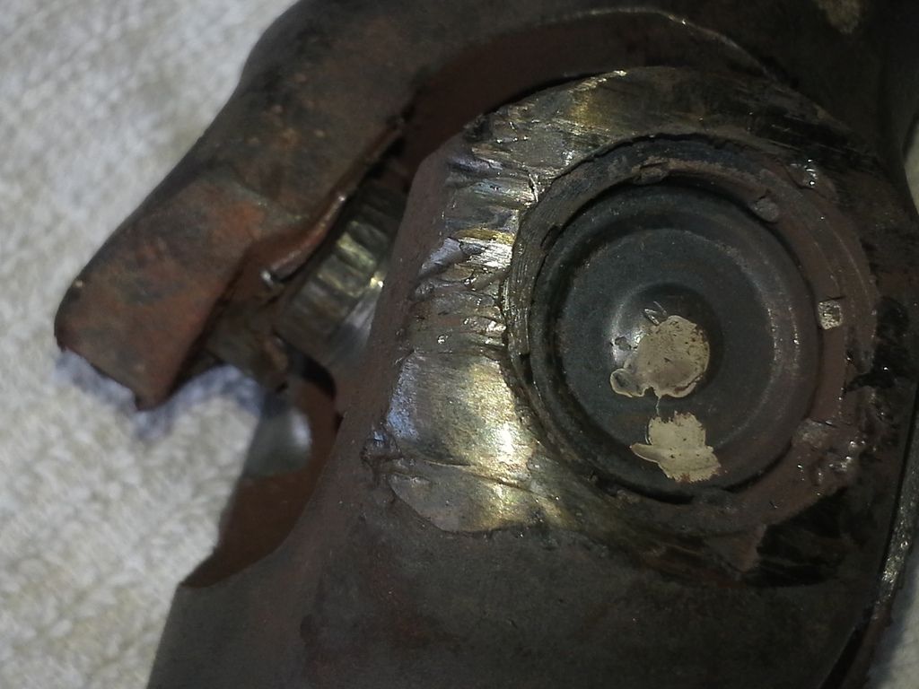

Take the rear wheel off figuring my pinion cup was probably dry...but it wasn't.   Pulled the boot off the U-joint and stuff started falling out...bearings.  Attached are pics of the U-joint....it really disintegrated!
I had just inspected the U-Joint about 5K ago...looked OK. Trying to decide what other parts to replace but a close inspection shows no wear on any of the shafts or pinion cup...thought the rattling of the u-joint would have destroyed something else.
Moral of the story....don't wait, replace that U_joint.

That's a real bummer!  You did your due diligence by inspecting the part, but it is very difficult to tell if something is about to break by just looking at it.  I hope nothing else is damaged.  Good luck.

Mine looked pretty much like that when it committed suicide at around 65K.  Fortunately, I was able to limp home.  No buffing that out.
Maybe not terribly important, but before new installation, run a big brush up the swingarm a bunch of times, or compressed air down the swingarm, and try to get all the metal filings, crud and rust out.  I also squirt a bunch of brake cleaner up there, wrap my big bottle brush in a rag and run it through a bunch of times.  Like a big 2-gauge shotgun barrel. No sense contaminating a new installation/lube.
Big BF pulled mine out of my lower mile IS last week (55K) and reported that it just wasn't right (it might go another 3-10K, or it might not).  It looked very right, but had just a wrong bit of wobble to it.  It had never caused a single symptom when riding.  So my new backup went in.  Thinking of standing out in the middle of nowhere with no cell service and no help made that decision for me.

There is no common mileage factor in Ujoint failure; other than they can go after 45K or so, or last forever.   When they fail, they usually turn to junk in short order.
Too many variables, including riding habits, water in the works/boot, and bad luck.  You can't really lube one (other than a spray of oil which might last for a few hundred miles), but you can inspect them at tire changes and rear end service intervals.
They do fail enough to have one on hand.  They ran out of them for many months once before, and the price on them never went down (but did double soon after the shortage).
