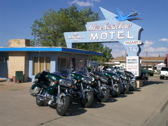

Here's a picture of mine. Doesn't show the clips but it's a great photo!
