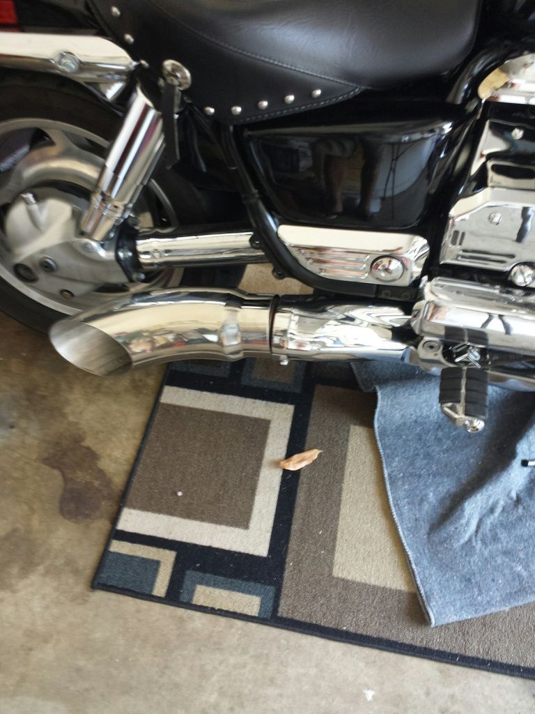

I've put on some modified oem exhausts. Basically cut just aft of the collector and installed a 4 x 15 in turn down. When I had my cobra 6 into 6 on the bike I had to reset the mixture screw to 2 1/4 out to stop the popping. That I assume is caused by running to rich. ( from what I understand from other threads). That worked fine and had no popping. Iinstalled the exhaust as mentioned above and have rode and reseated my exhaust nuts 3 times. I then turned the mixture screw out another 1/2 turn. This helped a lot on the popping. Only get it on decal. I would like to stop it completely. Should I turn it out some more?
Will this harm the motor at all?  Thanks in advance.

« Reply #5 on: July 15, 2016, 08:03:41 AM »
Yea it's open. Here it is mocked up before the weld.

« Reply #12 on: July 15, 2016, 11:26:24 AM »
I don't think it's as loud as my cobras with no baffles. But I'm in front of the exhaust. It's doesn't have the lower growl of the cobras, little higher pitch. Not sure I like it. But want to get everything set right before I determine that. It makes the engine look so much bigger. Not that it needs any help. Grin

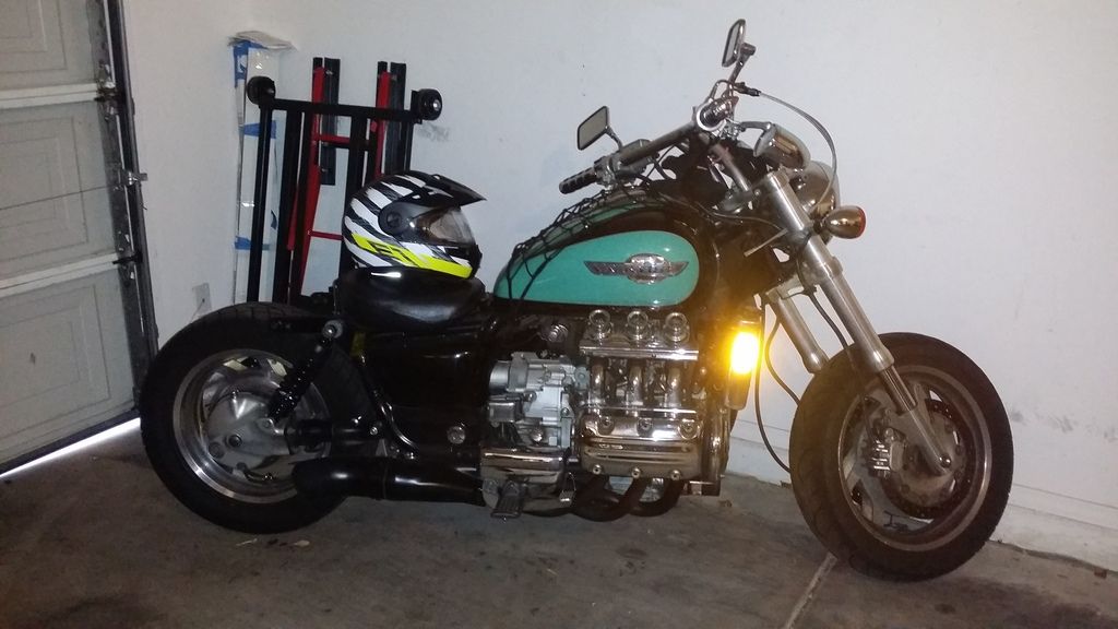

Posts: 13664
« Reply #18 on: July 28, 2016, 03:23:44 PM »
there will always be some popping, when getting off the throttle to closed throttle, it will go lean, nature of carbs. if u go pig rich then popping will go away. u will have to change oil sooner due to excess fuel getting past the rings which when doing that is washing the oil film off of the cylinder walls which equals high wear.
Why do u think HDs with open pipes don't pop and need to be rebuilt so soon?

« Reply #19 on: July 30, 2016, 05:07:24 PM »
Nice tire and nice exhaust....it does make the engine huge
