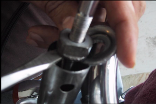

Britman, the best tool I've found to push down the spring collar is a ΒΌ-inch ratchet wrench (last pic). The
ratchet's square head fits just right into the round hole on the spring collar.
