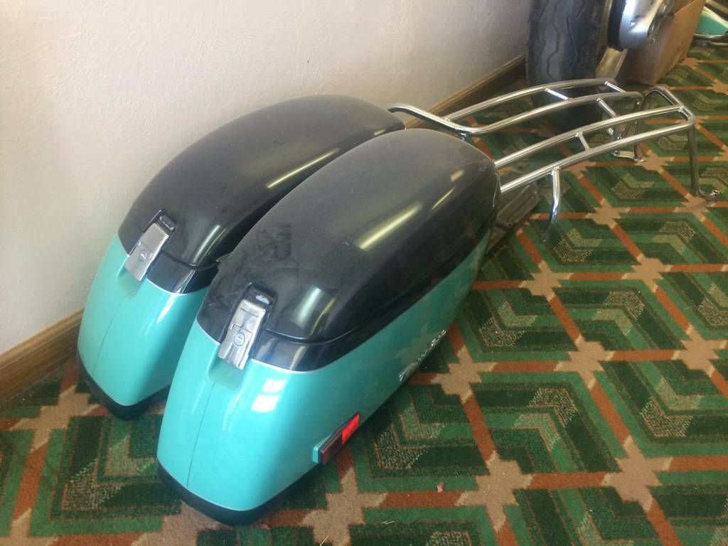

Feel a bit silly asking this, but I have lucked into a set of OEM Tourer bags, but need to have the bases painted (the lids are nice and black, as needed).  I pulled the lids and hinges, and got the "Tourer" emblems off with no problem, but I cannot see how the reflectors are attached.  There are no through holes and the heat gun and dental floss (or fishing line) don't seem to work on the reflectors.
Could anyone please throw me a bone and let me in on the secret?
Thanks in advance!

Thanks for the help, guys.  Basically, when I heard that it's just tape, I "manned up" and heated the thing up a little more and fishing line cut through it.
Bags are out for paint.   Pretty stoked.  Got OEM bags and rails from trike takeoffs.
These:
Are going here:
