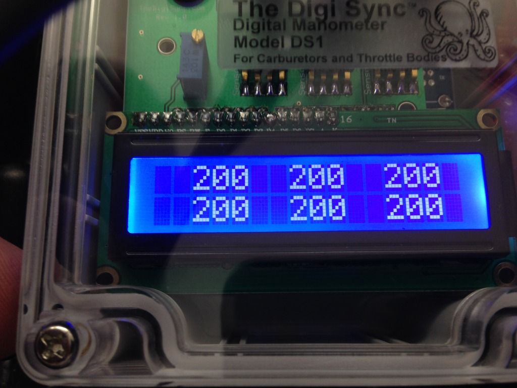

I ordered a Digi Sync this evening. It's been years since I've synced my carb's, and that was with a home-built manometer.
*EDIT*
My Digi Sync came in. It's pretty darn slick! It took longer to hook it up than it took to sync the carbs. The starting numbers were actually closer than I thought they would be. Last time I synced them, I used my home-built manometer. And that was probably  4 or 5 years ago. (more or less)
With the Digi Sync, It didn't take long before I had it pretty close.   cooldude
Before:
After:
« Last Edit: August 06, 2016, 10:33:33 PM by Bugslayer » Logged

I just got one and a 5 year old could do the sync. Be sure to close off the vacuum line so fuel still comes from the tank while you adjust the carbs.
Really good solution to the problem.  Got my carbs within a 1/10" within minutes.

  I set two bikes up with a manometer and then checked with a digisync.The mano gets you within an inch , the digi is within a tenth. It is so easy to use that you will look for bikes to set up.

I'm more than curious to see how far off my carb's are. Is it advised to have a fan blowing on the radiator to keep things cool(er) while you're syncing? Or does it even help?
The reasoning behind using a fan is to keep the engine cooling fan from activating, thus changing the idle speed slightly, while your syncing.
I think a second purpose might be to pass air over the headers to keep them from unreasonably heating.
As mentioned above that's hardly needed with the DigiSync as you'll have those carbs synched in just a couple of minutes.
