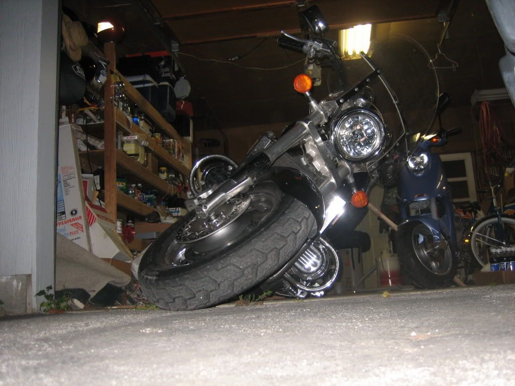

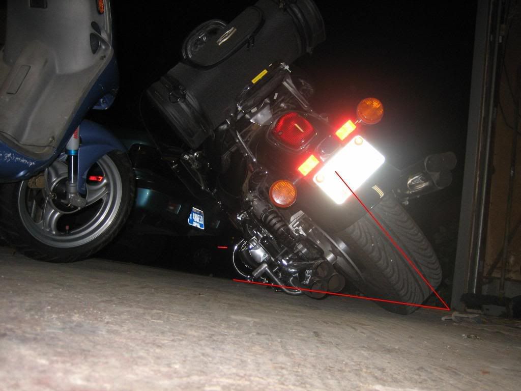

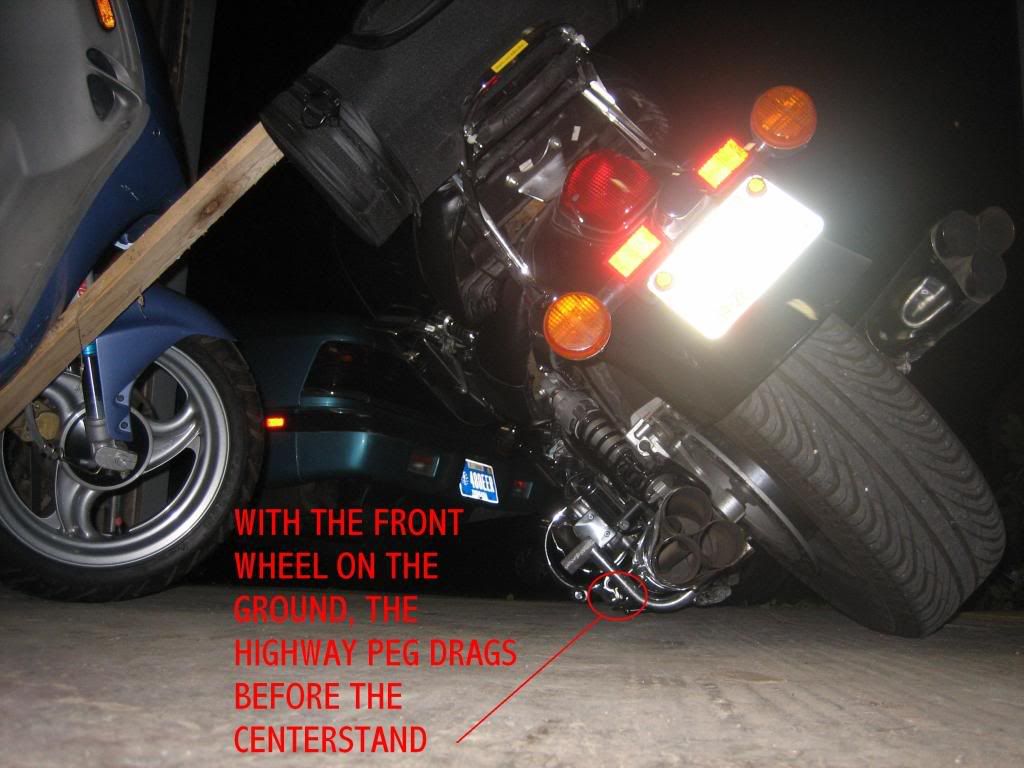

« Reply #12 on: September 29, 2009, 09:38:39 PM »
I have a Rivco centerstand and have scraped the driver peg without touching the arm on the stand.  I know a lot of people including Smokinjoe don't like them and believe them to be dangerous.  I would only say to each his own.  One thing about Joe's situation, I believe the aftermarket exhaust and the improperly adjusted stand contributed to his issues.  Here you can see the stand is at least an inch below the pipes.  With stock pipes and proper adjustment the stand is much higher.
I agree and I think he was limited in maximum C-stand height position by what appears to be rigid [other than flipping up] Cobra passenger boards not allowing proper clearance height. That, pictured, C-stand is much too low to be safe!
I have Kuryakyn passenger floor boards that would have created the same problem for me, but I also added the Rivco adjustable passenger floor board mount.
It's a 6 position adjustable mount of CNC billet. In it's uppermost position it hits the saddle bag and in it's lowest it causes the board to push the Rivco C-stand down. That's not a conflict by Rivco as there adj. mount came with crappy shorter Emgo boards and cleared their C-stand arm & saddle bags.  I modified a set of Kury's that are a little longer and just barely catch the C-stand foot bar.
So a designed 6 position mount is now a 4 position on my bike. But 4 is enough for my passengers needs.
Note: You can see in the picture that my C-stand is adjusted practically to the point of contact to my exhaust pipe. Another 64th and it's vibrating on the pipe. I have to use a towel when I take it off the stand to prevent it from compressing the rubber bumper and slamming the pipe. Not visible is the scuffing on the underside where it curves under the pipe which happened at the lowest pictured position. It was light contact, not enough to dangerously unload my rear suspension. But, enough to let me know just how far maximum lean is on the left. I have Kury rider pegs and they contact the pavement a little later then OEM rider pegs and those are ground down pretty good!
Point being, my elevated Kury rider pegs touch later then OEM, but before the C-stand. So in my setup scenario my left rider peg contacts before the C-stand on a hard lean making me aware that the rigid C-stand is not far behind with potential trouble.
If you ride really hard you can know your max limits, but you can't know a slight pavement elevation that could catch the C-stand arm and take you down hard. It doesn't take much. Simply know your bike as it's setup or as stock. Not much difference in my book to be safe.
If the C-stand is adjusted slightly lower then mine is it seems it can contact before the OEM rider pegs do. That requires a BIG warning to you all with that setup. Get that C-stand adjusted all the way up. Buy yourself a little extra lean room for emergency maneuvers. And if you don't know your setups limits then don't ride as if you do.
As mentioned above. This should be a none issue for many here with the Rivco C-stand. But at close to contact you don't have any room left for rider error in judging speed/lean angle if additional emergency compensation is required.
And as mentioned a few times.
Make sure you suspension is setup properly. I know that many riders on all types of bikes are set way too soft. Most riders pay little attention to suspension unless they rattle there vertebrae on a big impact.
« Last Edit: September 29, 2009, 09:49:17 PM by DFragn » Logged

Hey, I am not trying to sell centerstands and do not recommend that anyone put something on his or her bike that the person is not comfortable with.
Here is what I have discovered.  On my bike, the footpegs hit first by a long ways.  Next are the brackets for the highway pegs that stick out about an inch below the engine guard.  Finally, the centerstand will touch the ground (but by this time, the front wheel is off the ground.
I realize that the photos below are with no weight on the rear suspension, and I know the centerstand will hit quicker with my fat arse on the bike (and even quicker with a passenger), but I have to agree with the others that mounted correctly with normal suspension, the centerstand will hit only if the bike is being ridden by the most aggressive rider.
The mounting bracket on my highway peg is slightly lower than the engine guard:
The front wheel is off the ground in this picture:
The bike is right at a 45 degree angle when the centerstand touches the ground:
One last shot:

I do run a centerstand, and I do manage to drag it occasionally...keep in mind, the aggressive rider will be powering hard out of the corners and this substantially squats the rear suspension.
It's just something to be aware of.
