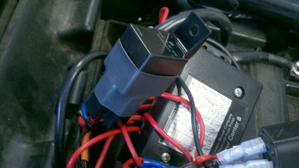

Kill switch is in bike run position.
I had an Eastern Beaver PC 8 fitted by BigBF. It runs extra driving lights, heated handle bar grips, heated jacket, battery tender.
Did a 600 mile run up the BRP and back with no problems 2 weeks ago.
Had the bike out of the garage this morning cleaning wheels. Turned the key to crank 'er up after cleaning to help dry water spray off.
Heard a click and no bike start. The little red oil light on the instrument gauge flickered each time I tried to start the bike.
Battery terminals are tight.
Fuses from the fuse block are good.
I haven't checked the main 30 amp fuse yet. Wanted to get the electrical brains among you cranked up.
Off to check main fuse.
If that has blown what might cause it? Bad ground? Rubbed wiring after rewire of accessories?

Try jumping across the poles on the start relay. If that works I'd probably check the handlebar start switch.
« Reply #9 on: August 22, 2016, 06:58:52 AM »
I'm not doing that because I don't know what that means. It's electricity the work of the devil.  Cheesy

« Reply #12 on: August 22, 2016, 07:56:18 AM »
Take this thing off, like you're checking to see if it is OK:
Hold onto the handle of a screwdriver and lay the blade across the
connections where the relay was. You starter should start cranking away.
If it doesn't, people here (not me) will have more to go on to help you.
-Mike "I think electricity is the work of the devil too..."

I've heard people talking about it, and I did it by mistake last time I checked the
relay. No sparks and my bike still works  cooldude . It should be as if you are in neutral,
bike off, and you press the starter button. The starter should start cranking away.
I pretty darn sure my key was even off, it by-passes a bunch of circuitry, that's why
it helps knowledgeable people give suggestions about where your problem might
be. You'll either be "good to there", or not. Hopefully some of those knowledgeable
people will chime in here...

Doing the screwdriver thing was a bust. No sparks, no nuttin.
I plugged in the battery tneder and turned the key and this relay? made a whining noise.
I'll leave the battery tender on for a while longer to see if that makes a difference and if the bike then starts I'll whip the battery out and take it to get checked.
Busy looking for battery receipt right now  Sad
