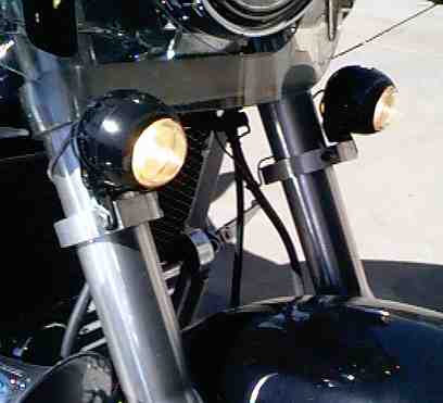

Thanks for all the input. I ended up going with Memphis Shades MEM9954 Fork Clamps. They may not be chrome but they are low profile and allow the fork shield and fender to pass by them during fork compression. Which means they are low, they are sprung weight, they turn with the forks, and they are closer to the front of the bike. All things I was shooting for. The inside of the clamps are lined with Aerocel's 24 mil Pro tape to add grip and prevent marring. (Not cheap and I have extra, if you want to go this route message me.)
Mounted to them are SuperBrightLed's AUX-R25C 10 watt LED lamps, 25 degree. All the hardware shown came with either the clamps or the lamps (the lamp bracket is not stainless  Angry). CAUTION: be sure to add washer(s) to keep the allen head bolt which holds the lamp bracket from protruding through to the fork.

Here are the photos to go with my latest reply. Thanks
