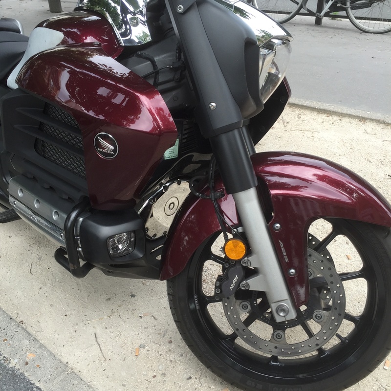

It's not difficult to take it off, I did it to change the spark plugs. Of course, I lost one of the six rubber buttons which protect the bolts but I'm the only one to notice
Following Robert, I bought a chrome front cover from China, cheap and solid
