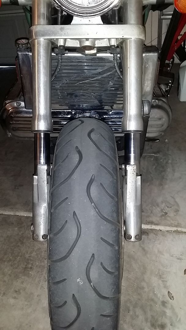

« Reply #14 on: September 09, 2016, 08:27:39 AM »
I like the Michelin Pilot Activ (rear) tire on the front.
Mine is 130/90-17 and it is mounted reverse of the arrow BECAUSE
I compared the tread siping direction to the E3 that was previously on it. If mounted with the arrow, the front siping will channel water inward rather than outward. I never bought into the belts/braking forces theory.
I had the same tire on my 93 (130/70-18, stock size) and just replaced it after 36,000 miles. <That is not a misprint. It wasn't down to tread wear bars but was cupping/feathering and roared in turns. I put the same size/model tire back on it. The rear has an ATT and was done for at 34,000.
This picture shows the siping matched, reverse from the arrow.
