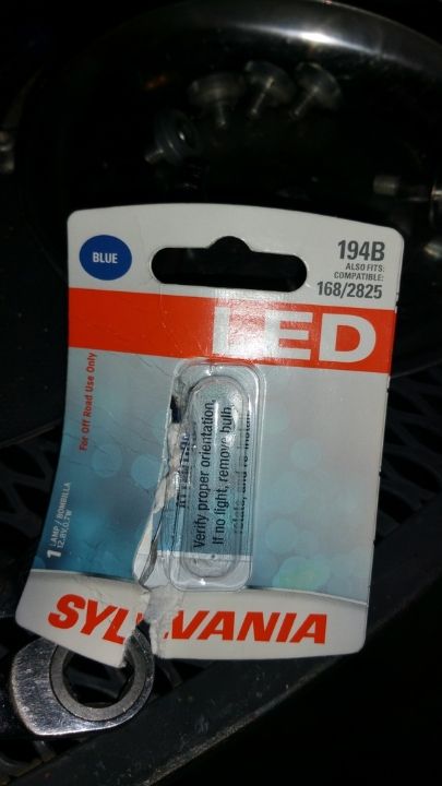

I just put in the 194 B SuperBright SYLVANIA bulb in "BLUE". I'm super stoked and waiting to see how it looks at night.
Remember...1 very small screw in the mileage reset knob (almost eyeglass small ) and my 03 has a screw on the back side of the speedo housing, close to the headlight housing not the bottom of the speedometer housing. Speedo housing came right off. Pull (gently) on the rubber light socket and install the new bulb.....nothing. Pulled bulb out spun it 180 and put it back in.....we got light !! Thanks for all the post on this "dim gauge lighting" fix.
                                                       Ride Safe !!!

  I had the same issue as to turning a bulb 180 degrees. I did not know a plug in bulb was directional.
  Others doing replacement , check before reassembly.

Curious how the blue LEDs work for you.  I put blue LEDs in and the gauges are almost impossible to read at night.

They are not as bright as the stock light.....but are still readable for me. I may switch to the superbright "white" ones later. These look good with my blue led's on the motor.
