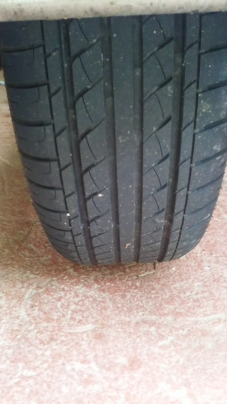

I ran it with too high a pressure for a couple of thousand miles. A common dark side mistake.

I was lying on the floor with the bike jacked up doing some maintenance when the Champiro tread caught my eye.
I'll keep this on for the Fall Color Ride and replace with the Champiro I already have in the garage.

« Reply #85 on: October 17, 2017, 08:08:26 AM »
Reminder of what the tire looked like when new.

13,500 miles
« Reply #110 on: December 05, 2017, 01:35:37 PM »
14,000 miles
Looks like it has some life left until you see it next to the replacement.
« Reply #111 on: December 25, 2017, 08:50:47 AM »
Riding on the new Champiro illustrated how flat the center had become on the tire recently removed.
Just like a motorcycle tire feels when transitioning from old to new.

Second Champiro at 5,000 miles.
« Reply #114 on: October 15, 2018, 06:47:42 AM »
It's all about the air pressure.
Kept at a constant 34psi cold since installation the tire still looks brand new. Looks like the photo above at 5,000 miles.
At 8,000 miles on a bike tire it would soon be time for a replacement.
Having too much pressure in the first Champiro definitely shortened it's life.

« Reply #117 on: January 31, 2019, 02:12:03 PM »
Well poop.
I've killed this one in just under 10,000 miles.
Had hoped it would last until the end of May.
Oh well, I'll have to use the one I have ready in my garage.
« Reply #118 on: January 31, 2019, 02:24:49 PM »
Well poop.
The right edge looks significantly more wore down than the rest. Optical illusion ?
« Reply #119 on: January 31, 2019, 04:04:43 PM »
Well poop.
Bald as a coot.
