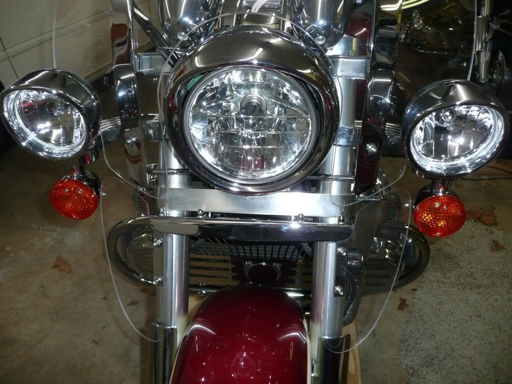

Did anyone add a light bar with the interstate fairing. I have an interstate and not sure I would have room for a light bar...
Thoughts,
Doug EP
My old I.S. on the right had a light bar from Barry at Big Bikes Things from Australia.

« Reply #10 on: October 02, 2016, 03:44:37 PM »
Light bar with fork deflectors mounted in place of lights, Big Bike Things out of Australia.
